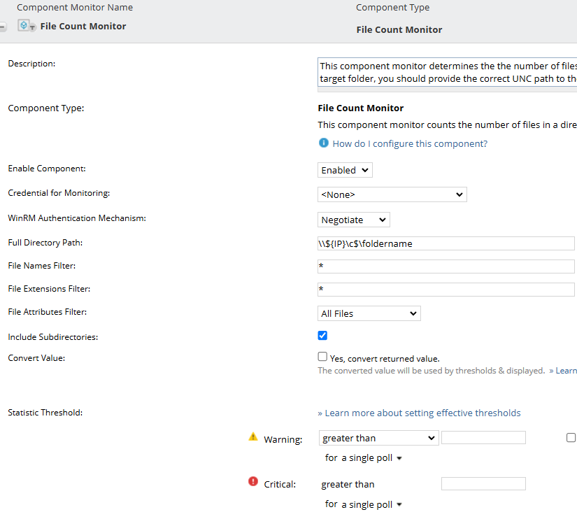

As @bobmarley mentioned, you could run a PowerShell script. Alternatively you could use the File Count Monitor (there is an out-of-the-box template or you can add the component monitor to a new template). Specify the location and any filters and it will come back with a file count. You can set the thresholds to be warning or critical at greater than 0, and then set up an alert to monitor that specific application/component status.
https://documentation.solarwinds.com/en/success_center/sam/content/sam-file-count-monitor-sw3221.htm

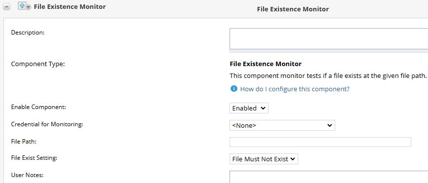

Or you can use the File Exists component monitor but I think that only has a Down/Red option not a warning/critical.https://documentation.solarwinds.com/en/success_center/sam/content/sam-file-existence-monitor-sw4755.htm

I would use Shuth solution, set the Warning or Critical level to Greater Than or Equal to 1The you can create an email alert based upon the file counter monitor targeting the correct Teams.if you are looking for a particular File Name or Extension, the change those element
ie. Only Log file. Entension "Log"Only MyLogfile_<Date>.* File Name "MyLogfile*", Extension "*"
