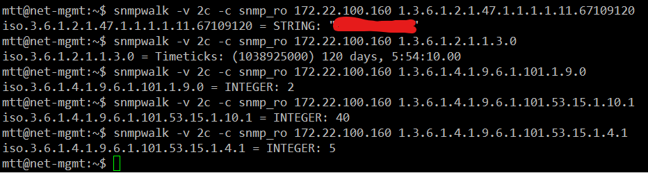

When doing a snmpwalk, i can find the servicetag, as well as sensors for temperature, CPU, uptime and fans (although fans are not present):

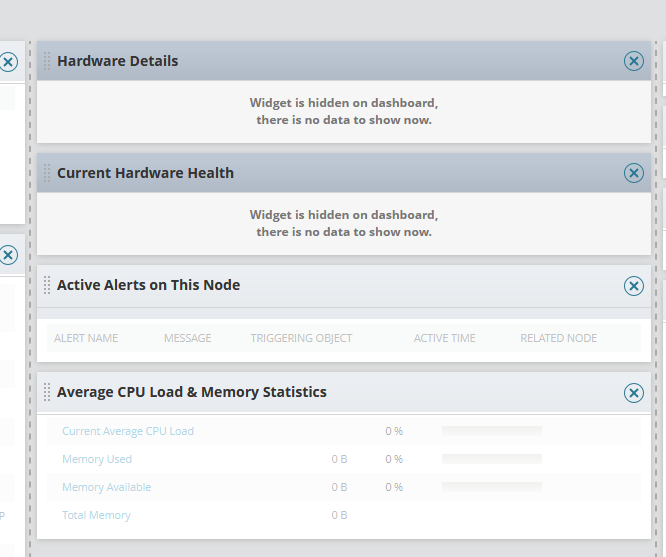

Below picture shows the (missing) 'Hardware Details' and 'Current Hardware Health' widgets for one of our troubled switches. I would love for both the available hardware sensors as well as the serial number/service tag could be present in these widgets or the 'Node Details' widget.

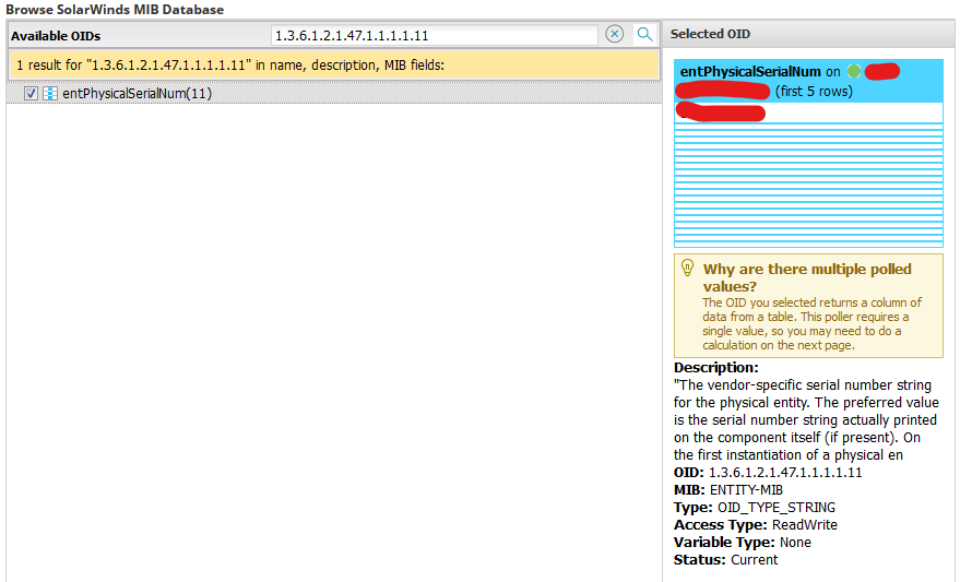

i continue with the 'SysObjectId' data source, since it is populated with the system OID and we never actively use that information for anything. I edit it, then browse OIDs and search for the OID i've found that holds the service tag, as also seen in the snmpwalk image, which cannot be found. But if i remove the long number after the last period, at the end of the OID, i can find the following, which i continue with. Please notice the output includes several empty lines.
I see im not the only one with an output that includes several empty lines: Cisco SG350 Switches and Custom Pollers
Like the guy in the link, I try to SubString and Replace the output, to remove the empty lines. With the help of ChatGPT, i also try to Truncate, IndexOf and Regex, but with no luck at all.
