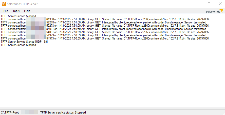

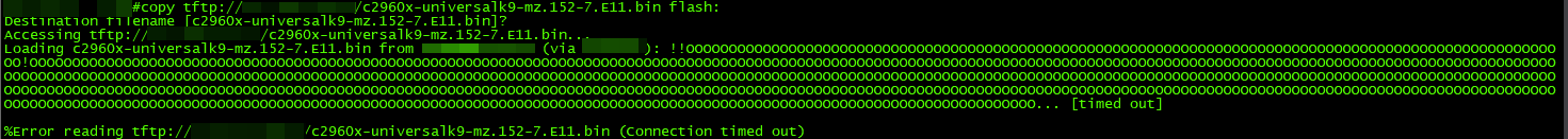

I have also tried using TFTP from the Windows virtual machine but I get a different error. As you can see from the screenshot below, the transfers starts but then the packets start coming out of order. I have stopped the TFTP server to prevent any potential issues so it times out then. If left it would still time out.
Looking the same transfer from the other side, that is from the SFTP/SCP servers side it looks like this, it gets interrupted by the client and then the session gets terminated.
