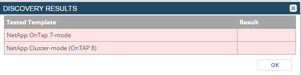

When I try to add array directly (NetApp Filer ) credential test past successfull but SRM cannot get any data target from array.
2016-06-29 12:57:08,133 [107] INFO SolarWinds.SRM.BusinessLayer.SrmBusinessLayerService - Net App Ontap Credentials: Username: vsadmin, UseSsl: False, Port: 0, Base Credential: ID:9,Name:netapp,Description:,Owner:SRM,IsBroken:False
Connection successfully
2016-06-29 12:57:08,274 [107] INFO SolarWinds.SRM.BusinessLayer.SrmBusinessLayerService - OIP EW logging: ProviderStep, Discovery: Selected Providers...
Provider: IP Address: XXX.xxx.XXX.XXX, Credential Name:
2016-06-29 12:57:08,352 [173] INFO SolarWinds.SRM.BusinessLayer.Jobs.DiscoveryJobLifeCycle - Submitting Discovery Job with inputs:
Template IDs: 7c189751-66b1-47c6-bf53-17e0ce4c04a6, 507edbc0-59d1-41d3-817c-78263849ca09
Host: XXX.xxx.XXX.XXX, CredName: netapp, QueryTimeout: 00:10:00
Max Async Queries Count: 5
Query Timeout: 00:10:00
2016-06-29 12:57:31,308 [177] INFO SolarWinds.SRM.BusinessLayer.JobShedulerEventServiceListener - Job results received [89b6f63a-422d-48f5-8096-0b91903cb338], removing job...
2016-06-29 12:57:31,308 [177] INFO SolarWinds.SRM.BusinessLayer.Jobs.DiscoveryJobLifeCycle - Discovery result for deviceType: 'NetApp OnTap 7-mode' is: 'Success'
2016-06-29 12:57:31,308 [177] INFO SolarWinds.SRM.BusinessLayer.Jobs.DiscoveryJobLifeCycle - Discovery result for deviceType: 'NetApp Cluster-mode (OnTAP 8)' is: 'Success'
2016-06-29 12:57:32,868 [167] INFO SolarWinds.SRM.BusinessLayer.SrmBusinessLayerService - Discovery Job has found 0 arrays
