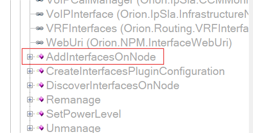

So what I am trying to do is to "artificially" add interfaces which I know are there and working and for that I am using SDK and the python orionsdk library and I had some success although the behavior is not what I expected,
I was able to add interfaces based on their indexes, but the problem is, they are created with the status unknown but they are never polled, so basically it stays in that state permanently which is not what I need. My assumption was that the interfaces would be created and naturally polled, as long as the polling interval was configured, but that is not what is happening. I suspect something is missing in the background that prevents the interface being polled like any other discovered via the proper way or maybe interfaces can't simply be added this way.
I am attaching the script I used which is basically a modification of an example I found on GitHub. Your thoughts on this would be appreciated.
