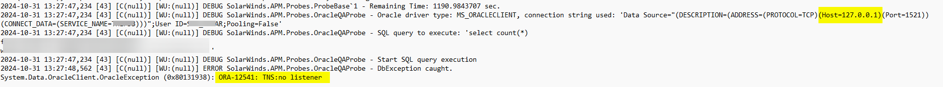

Then I set the necessary enviroment variables and restarted the Solarwinds server. I did a connection test with SQL*PLUS and I can connect. However, when I configure the component via Solarwinds UI, I got the following error.
‘Oracle returned an error. ORA-12541: TNS:no listener’
I took the application to debug mode and examined it a little and saw that it uses 127.0.0.0.1, that is, localhost as host. In other words, solarwinds does not use the tnsnames.ora connection file that I actually created. And it tries to access the db through the server I assigned the application. (I assigned the application to the main pooling engine.) How can I prevent this? How can I ensure that solarwinds uses the tnsnames.ora file?
