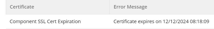

Hoping you can help. I'm trying to bring back a table of SSL's sorted by their expiration to show upcoming certificates that need replacing
This is based upon a monitor that uses the following PowerShell. The monitor itself works fine, and provides the values for expiration

I can get a list of the ssl certs using the following SWQL
SELECT
[Components].Name AS [Certificate]
FROM
Orion.APM.Application AS [Applications]
JOIN
Orion.APM.Component AS [Components]
ON [Applications].ApplicationID = [Components].ApplicationID
WHERE
[Applications].Name = 'SSL Cert Monitor'
ORDER BY
[Components].Name
However, i can't seem to figure out how to pull the expiration stat
Does anyone know how i might include that in the query?
