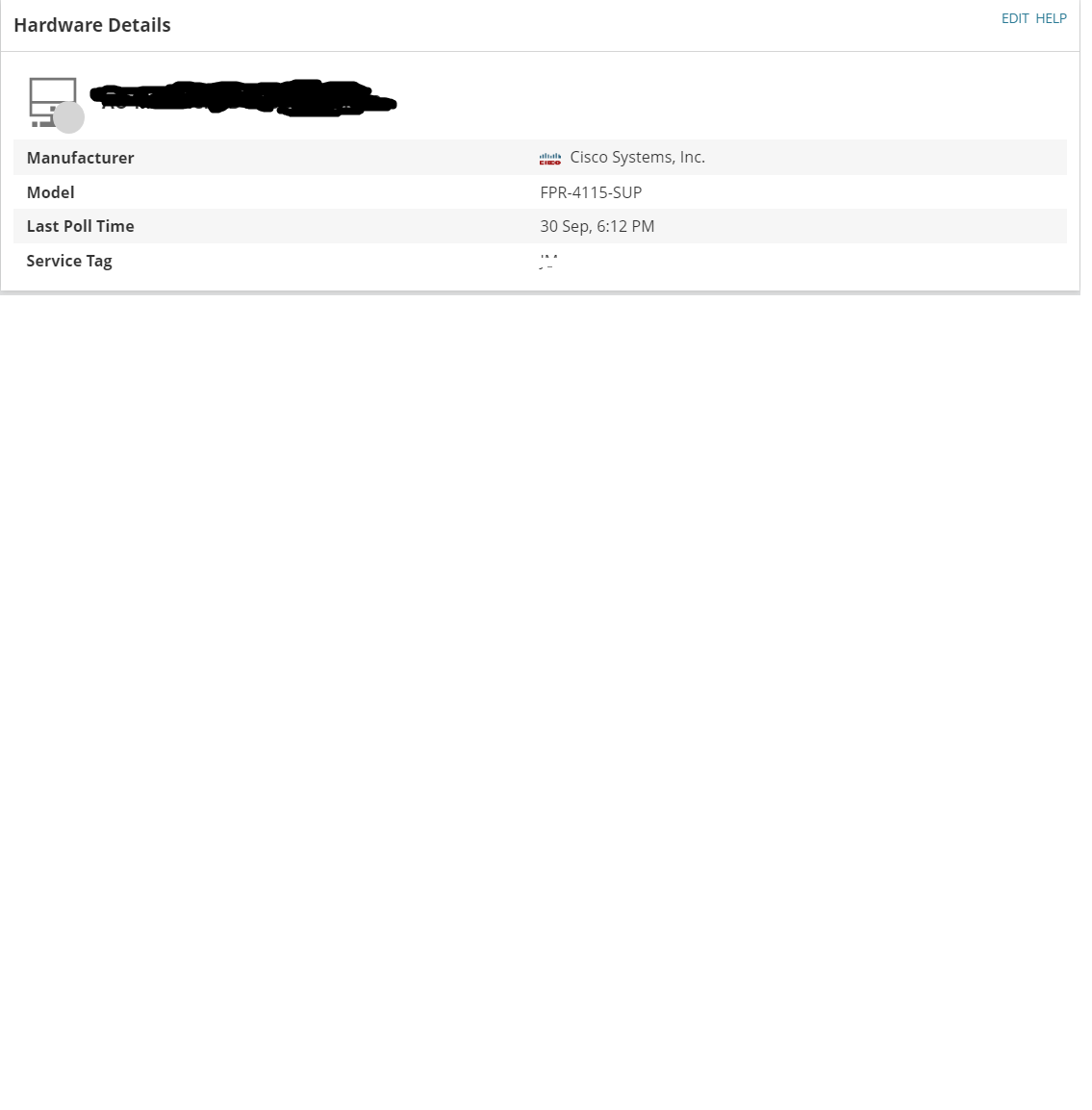

The device is up, SNMP is working but HArdware details are showing as unknown, How do i fix this?
Device details

Interfaces are fine, SNMP is fine. I did the SNMP walk ,Is there something specific i need to look in the snmpwalk?
i checked, i got the OID from a article SolarWinds support gave, no change there too
