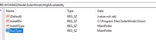

Registry Keys
The registry keys associated with HA are Install type and run type
HKEY_LOCAL_MACHINE\SOFTWARE\Wow6432Node\SolarWinds\High Availability
RunType = which role that server is currently fulfilling
InstallType = was originally designated as primary or main
When HA is stable, the keys will have both an install type and a run type of either standby or primary depending on active site.

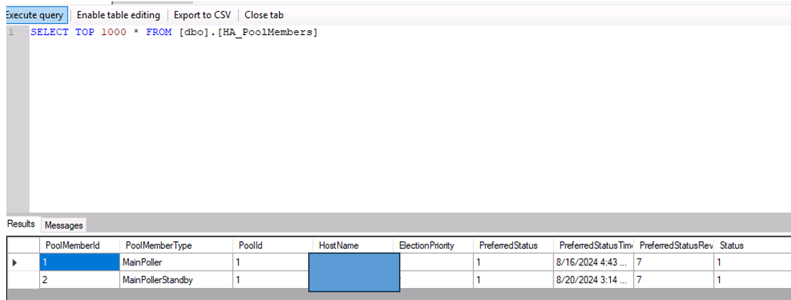

Pool members
HA pool members table will have a record for both the primary and the standby, and the pool member type field should match the registry keys.

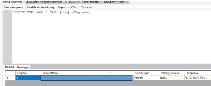

Engines
Engines table will show only the primary host of that pool, if both servers in the pool are displayed there is an issue with HA. This will be addressed in the troubleshooting steps above.

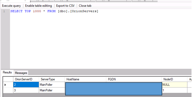

Orion Servers
Orion servers table will show both members of the pool and what server type they are built to support

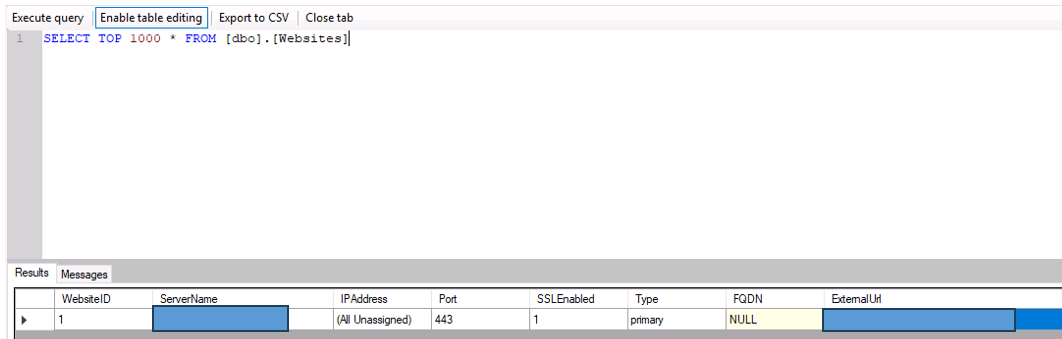

Websites
Websites table should only have 1 entry

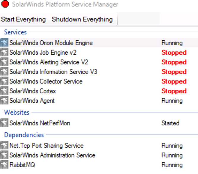

Services
On the active host you should see all services running for the modules that are licensed. On the standby host, you will see just the High availability service (not shown on the solarwinds platform service manager tool, only visible in windows services) as well as the below:
