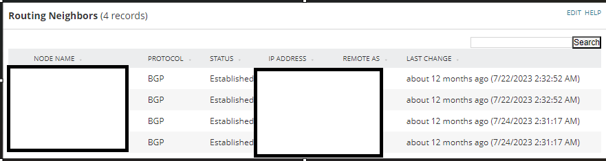

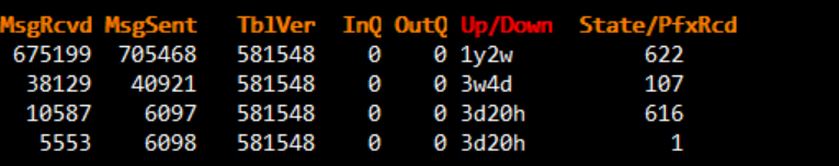

We have an issue where BGP Neighbors have been bouncing without our knowledge. I looked into the Node Details and see that the Neighbors report established for more than 12 months, but the router showing up/down for 3d20hr. I checked the polling and resources, and they are all correct with BGP monitoring selected. Any advice on how to refresh these neighbors, and get these to report as down when it bounces?
