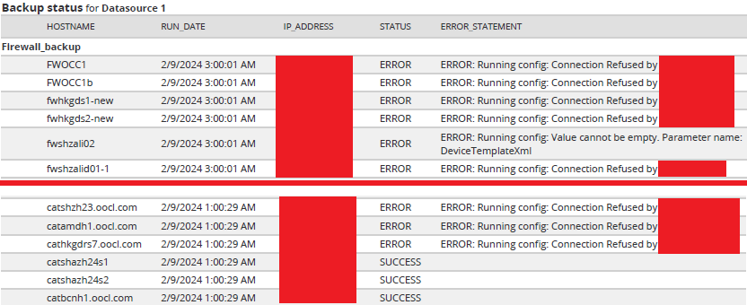

Before upgrading our NCM from 2020.2 to 2024.1. our backup report used to be like below.

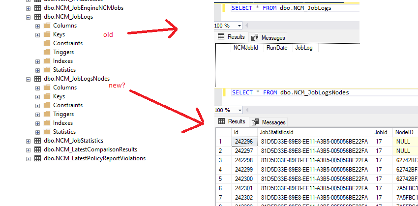

Afterward we found report wasn't updating at all and the run time in 2nd column stuck at 2/9/2024. After investigate I found the old db table NCM_JobLogs is empty now and those logs should be stored in a new location.

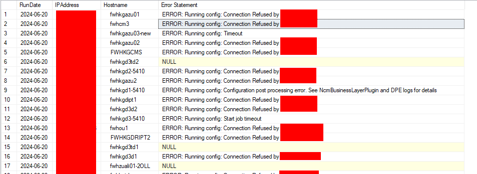

At first I checked this similar name table and eventually write a SQL through ChatGPT to extract log successfully.
WITH LatestRunDate AS (
SELECT MAX(CAST(RunDate AS DATE)) AS LatestDate
FROM dbo.NCM_JobLogsNodes
WHERE JobLog LIKE 'ERROR:%'
SELECT
CAST(j.RunDate AS DATE) AS RunDate,
CASE
WHEN CHARINDEX('(', j.JobLog) > 0 AND CHARINDEX(')', j.JobLog) > CHARINDEX('(', j.JobLog)
THEN SUBSTRING(j.JobLog, CHARINDEX('(', j.JobLog) + 1, CHARINDEX(')', j.JobLog) - CHARINDEX('(', j.JobLog) - 1)
ELSE NULL
END AS IPAddress,
CASE
THEN LTRIM(RTRIM(REPLACE(SUBSTRING(j.JobLog, CHARINDEX('___', j.JobLog) + 3, CHARINDEX(' (', j.JobLog) - CHARINDEX('___', j.JobLog) - 3), '_', '')))
ELSE NULL
END AS Hostname,
e.JobLog AS [Error Statement]
FROM
dbo.NCM_JobLogsNodes j
OUTER APPLY (
SELECT TOP 1 JobLog
WHERE JobId = j.JobId AND NodeID = j.NodeID AND JobLog LIKE 'ERROR:%'
ORDER BY RunDate DESC
) e
WHERE
CAST(j.RunDate AS DATE) = (SELECT LatestDate FROM LatestRunDate)
AND (j.JobLog LIKE '%(%):%' OR e.JobLog IS NOT NULL)
AND j.JobLog NOT LIKE 'ERROR:%'
AND CHARINDEX('(', j.JobLog) > 0
ORDER BY j.RunDate DESC
result of the code:
However I found the "error node" in report seems backed up successfully in fact. I could find most of those nodes latest backup config in NCM gui. May I know if I select correct table in db to extract log? Or if the DB table name is not default? Want to recreate a report for backup config job status. Please kindly guide me if any clue could provide. Thanks.
