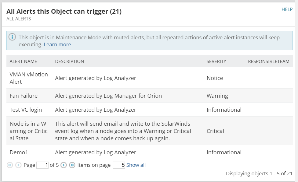

Not a great option, but then this is something that might help you a bit, there is a widget on node page which will help you with this, I have generic alerts in my environment hence this helps me, I wouldn't need to pull this out of a SWQL query. Ideally most of my alerts are based on vendor type which are generic in nature, hence I just select one node for that vendor and when i come onto the node page i can easily detect what alerts are tagged to that vendor type based on this widget. Check if this still exists in your environment on node summary pages, if it has been removed then readd it. Will make your life easier if you do not have 'n' number of custom alerts. If you have too many alerts in your environment which are not generic/global in nature then this wouldn't help much as its a lot of manual effort. Hope this helps.
