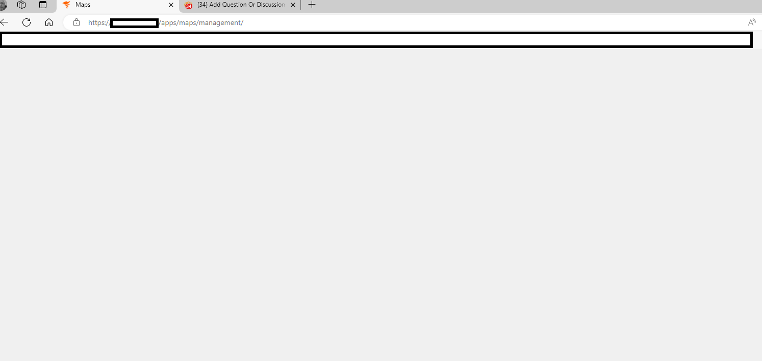

Hi, seem to be having an issue with SolarWinds Platform, when I try to go to anywhere that is linked with /apps all I get is a blank page, same happening with some of the Settings -> All Setting links as well.
It almost sounds like a catch all, but I would first try restarting IIS and if that doesn't work, give the configuration wizard a run for the web piece (Most of it is just next, next, next, etc,) Should have a small popup saying that the website is already in use on that port (which is fine, just continue). That usually fixes most issues that arise from the web side of things.
This is the way
OK, it is fixed turned out to be the web application firewall (WAF) blocking it, as it thought it was a SQL Injection attack... So if you see this at any of your customers, might be worth them checking their WAF logs.
