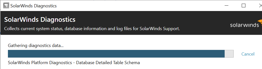

solarwinds diagnostics gets stuck on database detailed table schema.
I have tried running the configuration wizard as well before running the diagnostics. i am running 2023.3.1
Any idea?

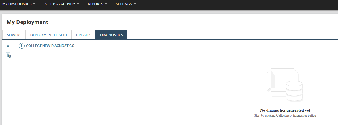

I'm assuming you get the same from the UI Settings -> My Deployment -> Diagnostics tab

got stuck here at the same place too...i was able to fix it though. Thanks
So what did you do to fix it?
what you did to fix ?
I checked in the logs, strangely SW admin service on 2 other Additional pollers were hung , i guess, I restarted the admin service on those 2 server, then the diagnostics completed , without error
