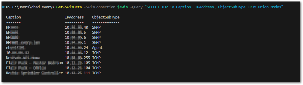

Just using some simple test SWQL queries.
Get-SwisData -SwisConnection $swis -Query "SELECT TOP 10 Caption, IPAddress, ObjectSubType FROM Orion.Nodes"

Your issue sounds intermittent, I can confirm that the Get-Swis line you posted is correct as it returned data without any issue in my lab.
