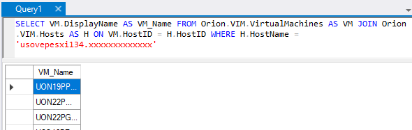

# SWQL query to get VMs running on the specified host
$query = @"
SELECT VM.DisplayName AS VM_Name
FROM Orion.VIM.VirtualMachines AS VM
JOIN Orion.VIM.Hosts AS H ON VM.HostID = H.HostID
WHERE H.HostName = '$esxHost'

I am trying to build a custom action that sends a message to MS Teams when a VM ESX Host goes down. The payload includes all the VMs that were running on the Host. The script above works fine when I explicitly define a host (e.g. myhost1.domain.com). HOWEVER, when I try to get the host dynamically using SWIS variables, it fails, and it appears the $esxHost variable is not populated. Am I using the correct SWIS variable and am I referencing it correctly?
