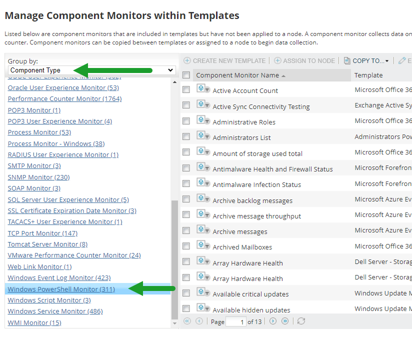

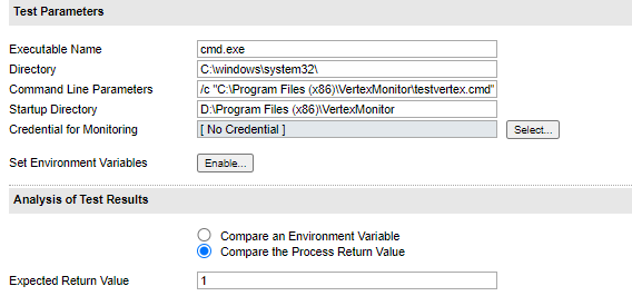

Currently in IPmonitor we have External Process monitors that run a cmd and return a value that we use to then setup alerts for. What would be the best method of setting up the same monitor in Solarwinds SAM? Would a powershell script that runs the CMD be the best solution or are there other alternatives? If powershell is the best solution are any examples available that could be built off of?
Below is an example of one of our setups in IPmonitor
