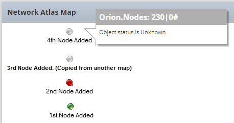

We're trying to update our Atlas map with two new nodes, a pretty simple task you'd think.
The problem however is that any nodes that are added to our existing map show up with a grey unknown status, as shown below.
The existing nodes that were added to this map previously however work properly.
The even stranger part of the problem is that I can create a new map and add nodes to it and have those nodes work. However, if I copy nodes from my existing map to that new map, those copied over nodes will show up in grey (as shown above), and then every other node that gets added to the new map will ALSO be grey.

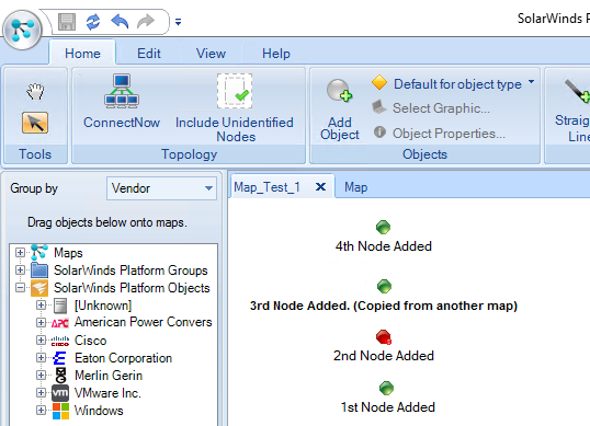

When I'm in Network Atlas, all of the nodes show up properly as well. So I'm not even sure where to start troubleshooting this issue.
