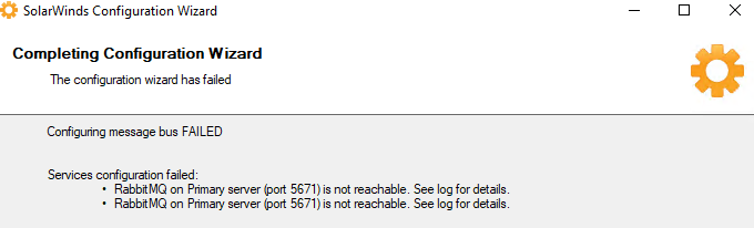

The pre-checks all passed, and it was only AFTER the upgrade was complete on the MPE (including configuration wizard run), when the configuration wizard step was being executed by Centralized Upgrade process on the APEs, that the problem reared it's head:
The configuration wizard on any of the Additional Polling Engines would not complete, complaining that they could not communicate with the Main Polling Engine's RabbitMQ:

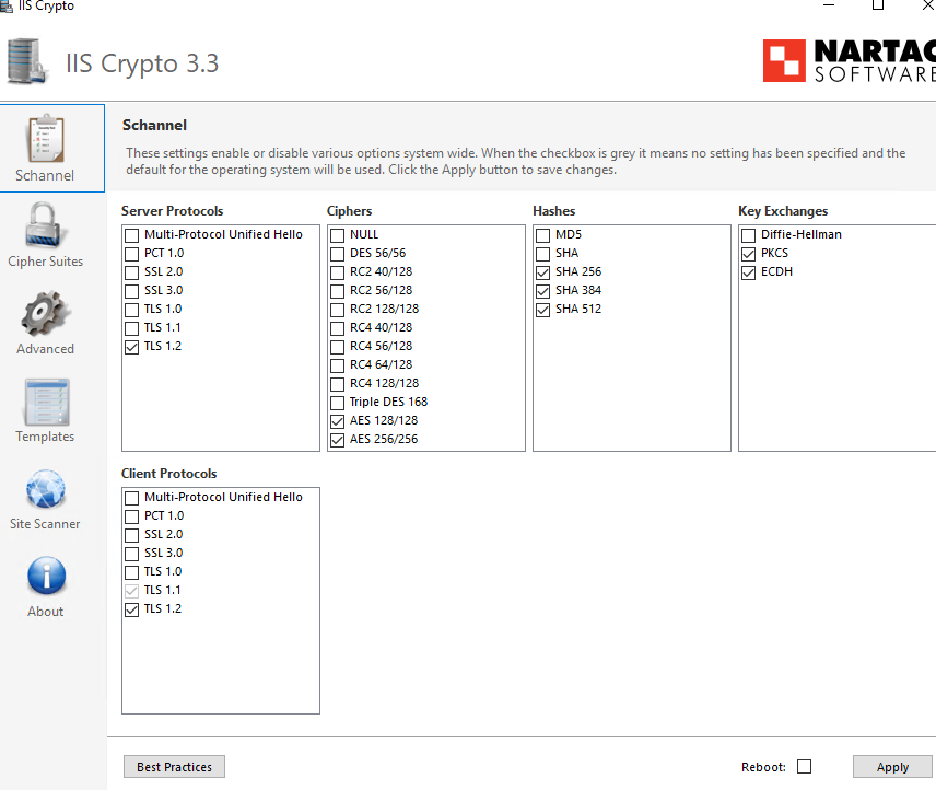

This got me thinking about the versions of TLS enabled between the MPE and APE potentially being the problem, as I have seen something similar in the past, I worked with support to find a resolution.
The issue appeared to be around crypto, a combo of TLS version mismatch and potentially cipher/hash/key exchange differences. The MPE was upgraded just fine.
Here's what the IIS crypto tool (a handy utility to have in your toolbox!) showed when the platform was broken, with the config wizards on the APE failing:
In the end, the solution from support was to download and run the aforementioned IIS Crypto too shown above (available from https://www.nartac.com/Products/IISCrypto/), and hit the 'Best Practices' button to restore any missing settings. This was done on the MPE and all APEs, and fixed the comms issues, and allowed the Configuration Wizard ran successfully on all six APEs. I had a working instance well before the client came in to work. Success?

For reference, this is what changed post the running of the tool:
- TLS 1.1 and 1.0 were restored to the server protocols, and TLS 1.0 was restored to client protocols.
- Triple DES 168 restored to ciphers.
- MD5 and SHA hashes restored.
- Diffie-Hellman ley exchanges restored.
