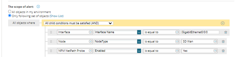

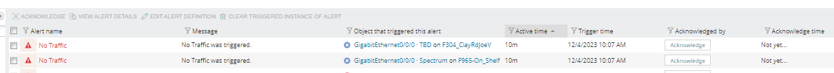

We are moving our branch infrastructure from MPLS to SDWAN. The vast majority of our Cisco SDWAN routers are connected to broadband connections with a modem, so if the Internet connection goes down, the interface still stays up due to it being connected to the providers modem. So we essentially don't know if an Internet connection goes down until the staff onsite notifies our helpdesk. I am trying to alleviate that by using the No Traffic alert. All of our Internet connections are on G0/0/0 interface, so I set conditions of Interface G0/0/0 in the SDWAN Node Type and if Total bps is less than 25k for more than 5 minutes, to make an alert. Which after 5 minutes, it did report two that definitely have no traffic on them as you can tell from this picture.

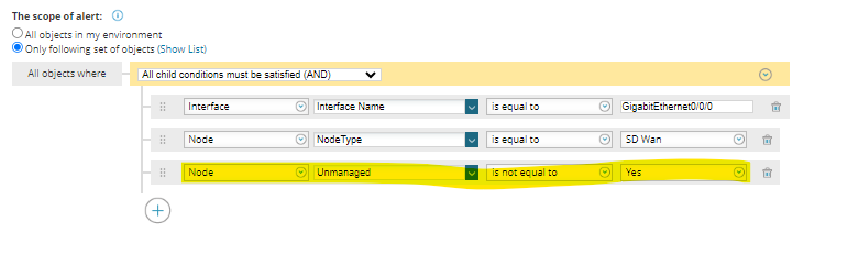

But it is two routers that we have unmanaged right now. Would I accomplish it ignoring unmanaged ones by adding the third line above (NPM NetPath Probe) and setting it to equal Yes as I have in the screenshot below?
If not, how would I get it to ignore unmanaged devices?
