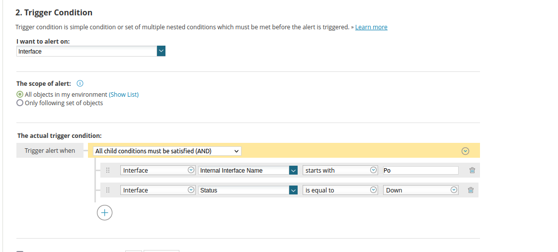

If you are after the actual alert - this is the SWQL from one we use
SELECT E0.[Uri], E0.[DisplayName]FROM Orion.NPM.Interfaces AS E0 WHERE ( ( E0.[IfName] LIKE 'Po%' ) AND ( E0.[Status] = '2' ) )
So this is for a Cisco Port channel when it loses a member.
