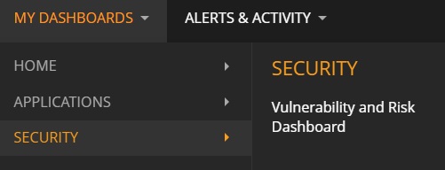

HCO Advanced Introduced the Security Tab - I do not see the option in User Settings. If this is unable to be done in the GUI how do I restrict this in using the database?
How can I remove / restrict this tab to different users?

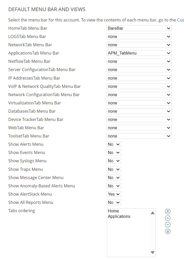

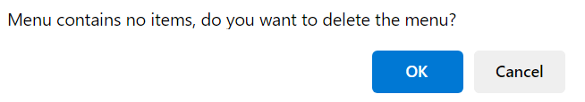

I was having the same issue, in the 2023.2.4 build you cannot restrict the Menu bar in the usual way in the User settings. Support confirmed that. I was able to find a way to remove it. To get rid of the menu option completely, you can remove the bar by removing all the buttons on the menu bar. Click Admin - CUSTOMIZE NAVIGATION & LOOK - Customize Menu Bars. Edit the Security_TabMenu and remove the Vulnerability and Risk Dashboard button. When you click Submit the system will ask if you want to delete the menu.

That worked. Thank you!
