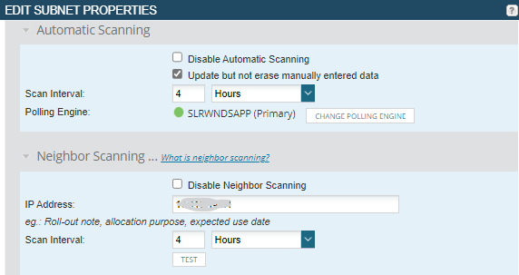

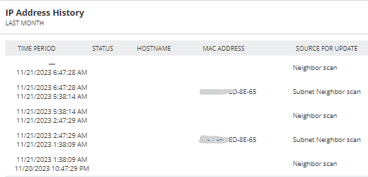

I have turned on neighbor scanning for the affected subnet (fortunately, it's mostly all within a single subnet), but that brings its own issues. IPAM does indeed retrieve the mac addresses through neighbor scanning, but the next subnet scan overwrites them so they aren't readily available (other than via history). We have both automatic scanning and neighbor scanning enabled; should these be mutually exclusive? The documentation is, of course, quite sparse on these kinds of details.

2. Neighbor scanning seems like a potential solution here, but should automatic subnet scanning be disabled for it to be useful? If so, this really needs to be documented. In this case, it may be reasonable to ONLY use neighbor scanning, but I could see this being problematic for subnets with a wider range of devices.
