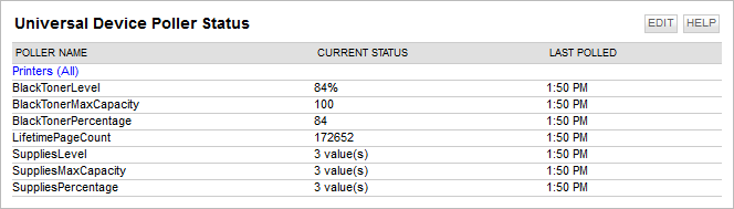

To make use of these UnDPs you must first assign them to a printer node. Once assigned, I would recommend adding the Universal Device Poller Status resource to the view you use for your printers so that you can see that the UnDPs are properly assigned and what their values are:

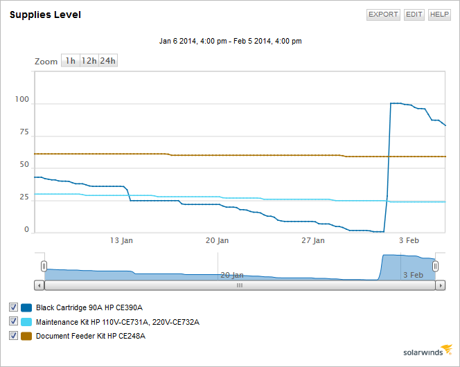

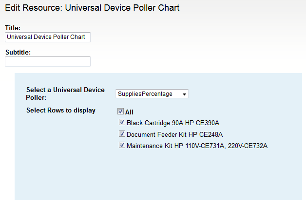

To graph them, you can add a Universal Device Poller Chart to the view and make it use the SuppliesPercentage UnDP. Once you've done so you can also pick and choose which of the underlying supplies you wish to graph:
This results in a graph that looks like the following:
