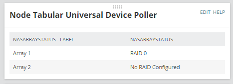

- nasArrayStatus. Indicates the current RAID mode/status of an array. Returned values: Not Supported, No RAID Configured, RAID 0, RAID 1, RAID 5, RAID 6, RAID 10, RAID 50, RAID 51, RAID 60, RAID 61.

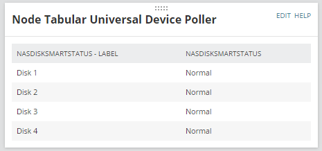

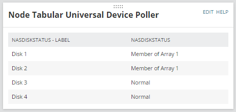

- nasDiskStatus. The current state of a NAS drive. Returned values: Unknown, Normal, Member of Array 3, Member of Array 4, Media Cartridge, Member of Array 5, Member of Array 6, Member of Array 1, Member of Array 2, Hot Spare / Normal, Removed from Array, Dismounted / Plugged, Hot Spare / Dismounted, Failed, Unplugged.
- nasDiskSMARTStatus. S.M.A.R.T. overall health self-assessment test results.
- nasDiskSMARTCurrentPendingSectorValue. S.M.A.R.T. Current Pending Sector Attribute.

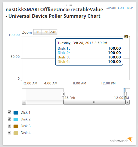

- nasDiskSMARTOfflineUncorrectableValue. S.M.A.R.T. Offline Uncorrectable Sectors Attribute.
- nasDiskSMARTReallocatedSectorCtValue. S.M.A.R.T. Reallocated Sector Count Attribute.

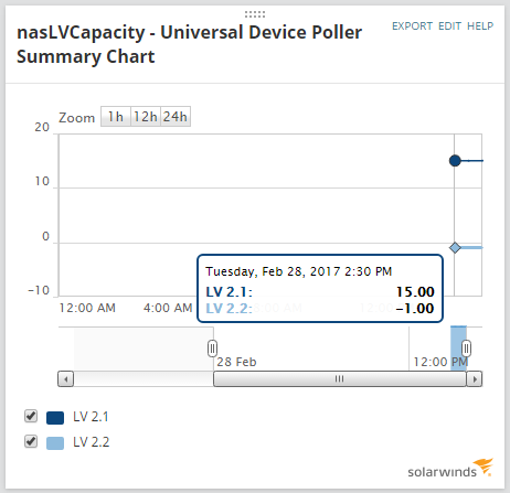

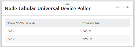

- nasLVCapacity. Indicates the capacity of a logical volume. The capacity cannot be obtained if the logical volume is configured as an iSCSI volume. In that case, the value -1 will be returned by the device.
- nasLVName. Name of a logical volume.

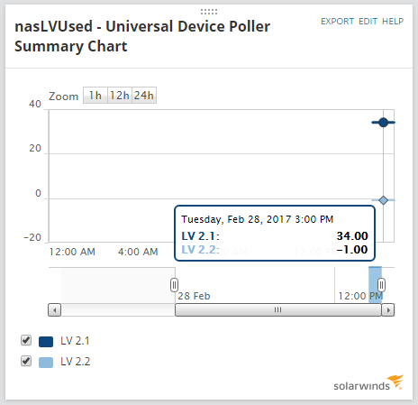

- nasLVUsed. Indicates what percentage of a logical volume has been used. The usage cannot be obtained if the logical volume is configured as an iSCSI volume. In that case, the value -1 will be returned by the device.

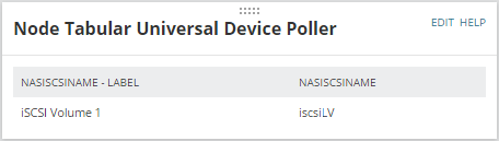

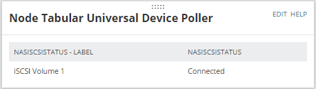

- nasISCSIName. Name of an iSCSI volume.
- nasiSCSIStatus. The connection status of an iSCSI volume. Returned values: Unknown, Connected, Standing By.

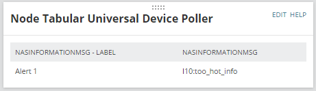

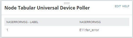

- nasErrorMsg. Codes indicating that an error occurred. See the manual for the model of your NAS for more information about error codes.
- nasInformationMsg. Codes representing warnings or status messages. See the manual for the model of your NAS for more information about status codes.

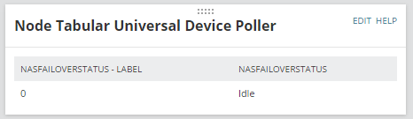

- nasFailoverStatus. Current failover status. Returned values: Idle, Busy, Starting Main, Starting Backup, Stopping, Initializing.

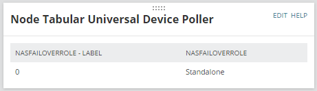

- nasFailoverRole. The role of the NAS during failover. Returned values: Standalone, EM Mode, Alone Backup, Main, Maintenance Main, Alone Main, Maintenance Backup, Backup.

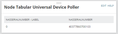

- nasSerialNumber. The TeraStation’s serial number.

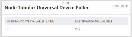

- nasIsFwUpdateAvailable. Indicates if a firmware update is available for the monitored TeraStation. Returned Values: Yes, No, Unknown.

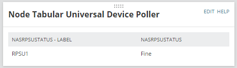

- nasRPSUStatus. Indicates the status of the redundant power supply unit of a TeraStation, if supported by the monitored model. Returned Values: Fine, Unknown, Broken.
