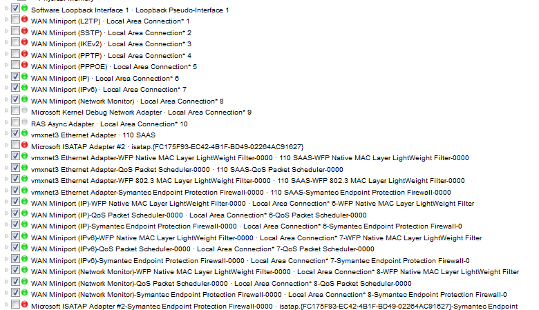

            However, I tried checking the license details of NPM and NTA in my work environmnent. Please see the screen shots below.
            From the above, I cannot suppose that the NPM license is finished but what I do not know is that of NTA. How many NTA licenses do I have left? I don't know.
            This is where I need assistance. Something is wrong somewhere. Why would Solarwinds (NPM and NTA) just stop to spool the information that it used to, about a network device?
