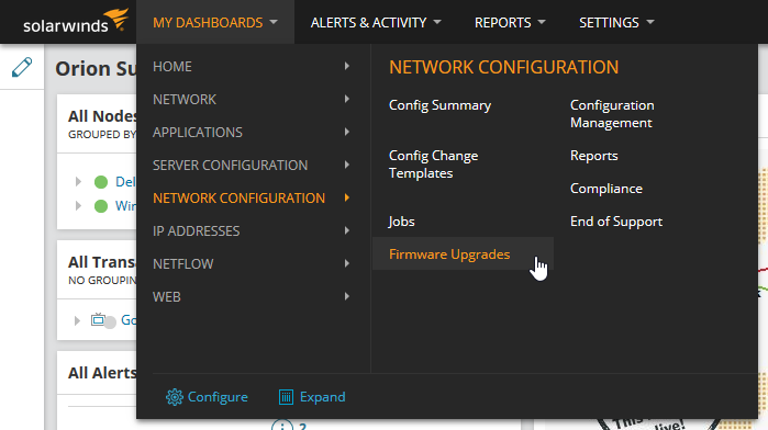

  • Hi
    NPM 12 is much better for monitoring and alerting in my opinion and more information available of the box now. To give an example for Nexus 7 this is what Hardware Details looks like in NPM12.
    Hope this helps.
