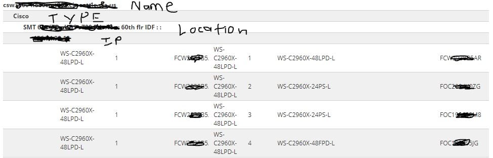

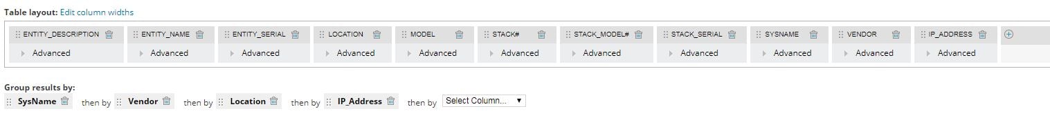

    Assuming you have both NPM and NCM, here's a SQL report that I built that pretty much supplies everything you're looking for.
    SELECT [dbo].[NodesData].Location
    ,[dbo].[NodesData].SysName
    ,[dbo].[NodesData].Vendor
    ,[dbo].[NodesData].IP_Address
    ,[dbo].[NCM_Entity_Physical].Name as Entity_Name
    ,[dbo].[NCM_Entity_Physical].Description as Entity_Description
    ,[dbo].[NCM_Entity_Physical].Serial as Entity_Serial
    ,[dbo].[APM_HardwareAlertData].Model
    ,[dbo].[NPM_SwitchStackMember].SwitchNumber as Stack#
    ,[dbo].[NPM_SwitchStackMember].Model AS Stack_Model#
    ,[dbo].[NPM_SwitchStackMember].SerialNumber AS Stack_Serial
    FROM [dbo].[NodesData]
    FULL OUTER JOIN [dbo].[APM_HardwareAlertData]
    ON [dbo].[NodesData].NodeID=[dbo].[APM_HardwareAlertData].NodeID
    FULL OUTER JOIN [dbo].[NPM_SwitchStackMember]
    ON [dbo].[NodesData].NodeID=[dbo].[NPM_SwitchStackMember].NodeID
    FULL OUTER JOIN [dbo].[NCM_NodeProperties]
    ON [dbo]. [NCM_NodeProperties].CoreNodeID=[dbo].[NodesData].NodeID
    FULL OUTER JOIN [dbo].[NCM_Entity_Physical]
    ON [dbo].[NCM_NodeProperties].NodeID=[dbo].[NCM_Entity_Physical].NodeID
    WHERE ([dbo].[NCM_Entity_Physical].Serial is not null and [dbo].[NCM_Entity_Physical].Serial <> '')
