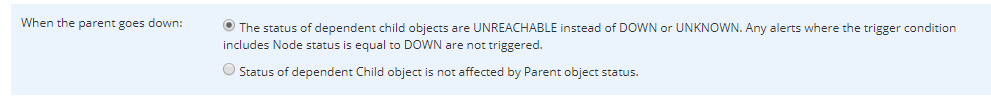

  • From the sound of what you described it would seem like there shouldn't be any additional weird logic, firewall goes down and is the parent of a group then everything in that group gets marked unreachable.  There's not much else to it.  In general with dependencies there is always a bit of leakage when the child nodes get marked as being down before the poller realized the parent is down, but if you had problems with that aspect of things then I would expect you to have it consistently across all groups, not just the firewall group.  This isn't just a matter of timing right?  The firewall children never get marked as unreachable?  How did you build those group definitions, if it was a script maybe there was something that is wrong with that script?  Does the firewall dependency relationship not have the setting correct for the options on how it should handle the parent down status?  You can set that to where the parent actually never does change the status of the children.

    Both dependencies are set that when parent is down,m the child will be unreachable and alerts on child will be suppressed.
