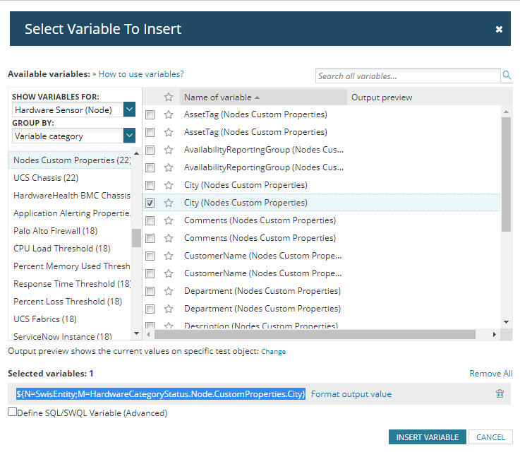

  • The "problem" here is that the target of the Node Down alert is based around nodes so ${N=SwisEntity;M=CustomProperties.Primary_Contact} says "the target entity of this thing (Node) with Custom Property called 'Primary Contact').
    A hardware sensor is a "child" element from Nodes.  (Nodes has multiple hardware sensors).
    If you use the "picker" in the alert variables, the Primary Contact custom property would look like this: ${N=SwisEntity;M=HardwareCategoryStatus.Node.CustomProperties.Primary_Contact} for those entity types.
    Ignore my screenshot - I don't have your same custom properties on my system.
    When in doubt, use the picker.

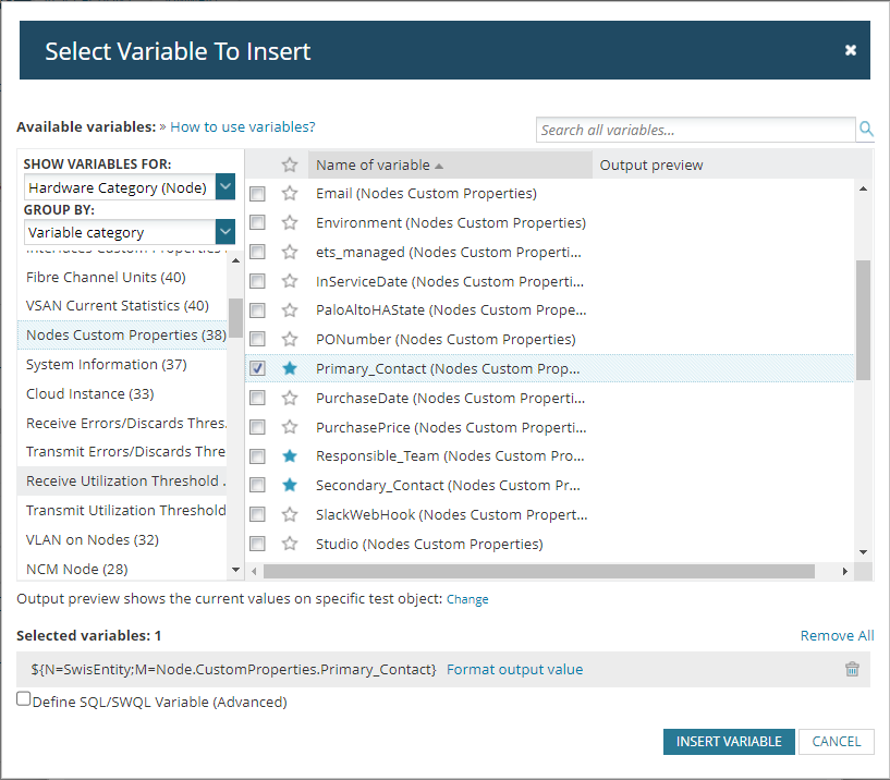

  • Hi KMSigma
    When I follow your steps and this was the way I grabbed the variable for the Email Address input my variable presents the same as variable already being used, and doesn't look like your example.
    This is what I see.
  • Should still be fine.  We might be running different versions of the platform.  Check the "Change" for the test object so you can see what sample output would look like.  (Note: I'm running the latest with 2022.3.0 reported)
  • ANSWER: The Screenshot KMSigma gave in reply here is different from your screenshot.  In show variables, try Hardware Sensor(Node) , not Hardware Category".. It will work.
    these parameters also depends on Source (I want alert on) in your trigger condition  "Trigger condition" page. Use Node, but select the hardware sensor status. this variable will work. Or use "hardware sensor (Node)".
