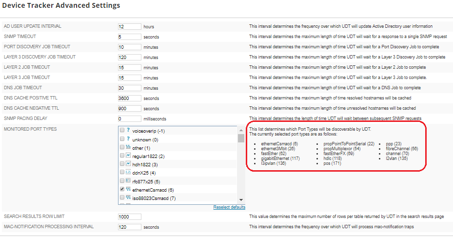

    I am still having the same problem w/ UDT.  By the way, I also noticed that the interfaces that our Polycom phones connect to always show as NEVER used.  I mentioned this to SW tech support and they asked for me to select the port types that are apply to our Polycom phones.  I do not know which port types to select. Below is a screenshot of the ports currently set in our UDT implementation.
    I don't want to select all the port types, lest it brings down SolarWinds to a crawl and/or makes for the UDT scan jobs to fail or not complete. Any ideas????

  • I know this is a late reply, but you should be able to quickly look up the interface types on your Polycom units in the Database Manager. Try this query, just replace X with the NodeID of one of the Polycoms.
    SELECT NodeID, InterfaceID,InterfaceName,InterfaceIndex,InterfaceType,InterfaceTypeName,InterfaceTypeDescription FROM [dbo].[Interfaces]
    WHERE NodeID = 'X'
