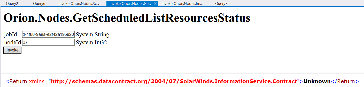

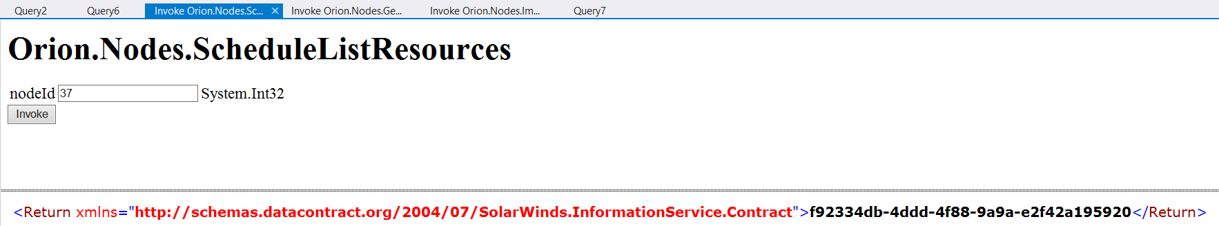

  • I wanted to bring this issue up as well.  In my experience this part of the discovery engine is extremely fragile.  Even if I'm not using a script to perform this, just using the verbs directly from SWQL studio.  The process of ScheduleListResourcesGetScheduleListResourcesStatus fails so often that automating our node lifecycle is nearly pointless.
    This is occurring in multiple environments for me.  Our production environment, our Lab (dev) instance, and even if I stand up another environment at work or at home using a trial license.  Often it won't work at all even after a brand new install.
    Even if it did work previously, when it does start to fail running the config wizard usually isn't enough to repair the problem, requiring reinstalling components to get this feature to work.
    Are other people experiencing this?

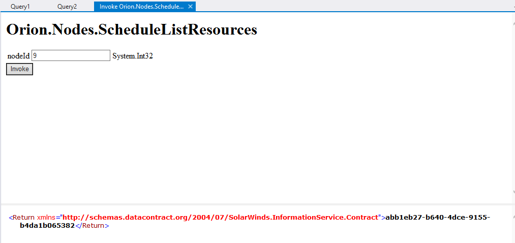

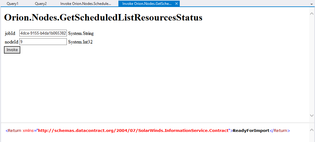

  • I just ran it with the latest platform version (2022.2.0) via the Hybrid Cloud Observability installer, and got back an immediate response on the node ID (with a resulting job ID)
    Then, sending that information to the next verb returned a ReadyForImport status.
    Granted, this is a small lab (under 50 devices), but all that would do would be to increase the amount of time it took to flip from Unknown to ReadyForImport.
    There may be "collisions" (I can't think of a better word) if the call was sent over and over again.  Are you seeing this on every node when you ask it to get resources?  Are you getting the same thing if you do it via the web console?  They should be calling the same verb behind the scene, so if it doesn't work on the web, you definitely need to open a support case.

    The ScheduleListResources works the vast majority of the time, but the GetScheduledListResources just stays in Unknown forever.  The website works fine (the List Resources button on the manage nodes page) even when the API doesn't.  Support doesn't assist with these issues since it's "API related", so we're left to figure it out on our own and via THWACK.
    I've found that sometimes re-installing the Information Service will resolve the issue, but usually not.  Most of the time a reinstall (or conveniently timed new version to install) is what it takes to fix it once the problem starts.
    Example of what we see:
    When this is occurring, it doesn't matter how many times I try the process, no job will ever leave Unknown status, and as mentioned in my previous post, running the configuration wizard doesn't repair it.
