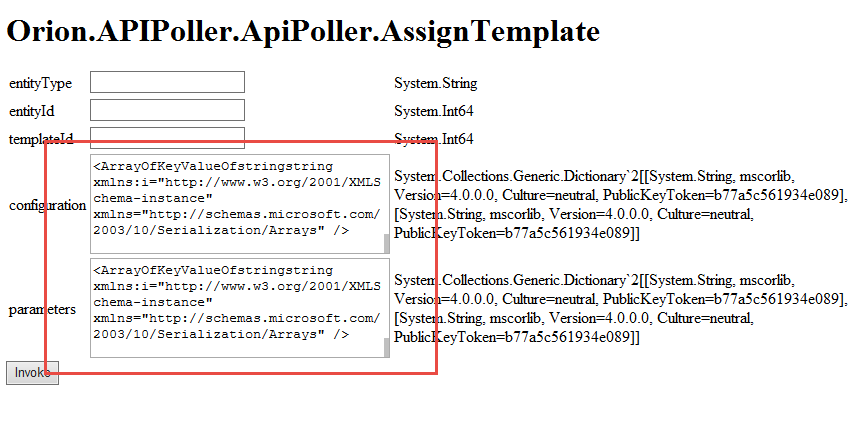

Assign API Template via REST Examples?
Does anybody have an example or link to the SDK that covers the "Orion.APIPoller.ApiPoller.AssignTemplate" Invoke method?
"Configuration" & "Parameters"  is really what Im looking for.
