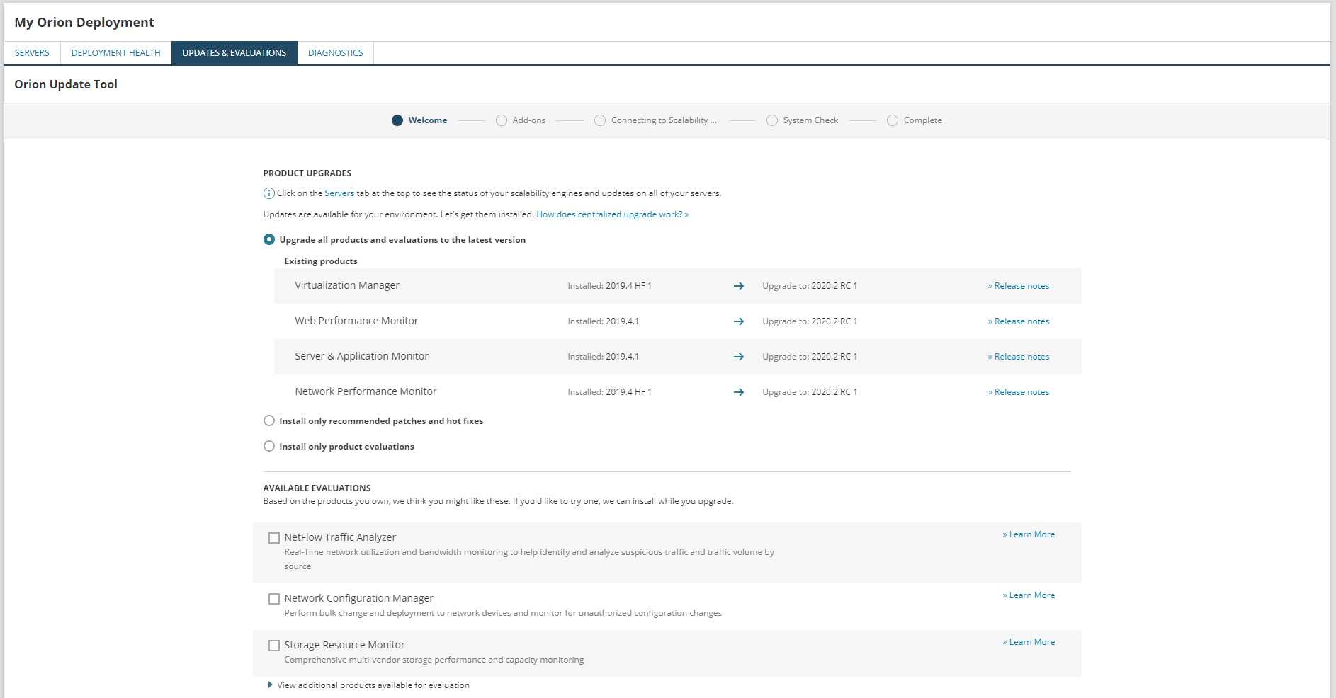

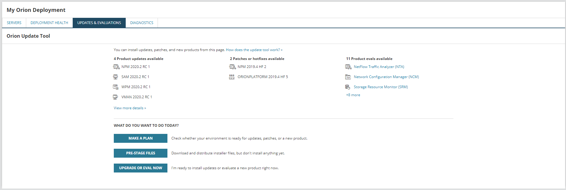

As an Orion Administrator, you will undoubtedly be familiar with the My Orion Deployment page within the web console. Upon visiting this page and selecting the Updates & Evaluations tab, you will be greeted by some adjustments to the user interface.
As you can see from the example above, the upper portion provides specific information in each of the 3 sections. The first section indicates if any major updates are available, the second calls out patches and hotfixes based on what is installed, and the 3rd indicates products that may not be a part of your current installation.

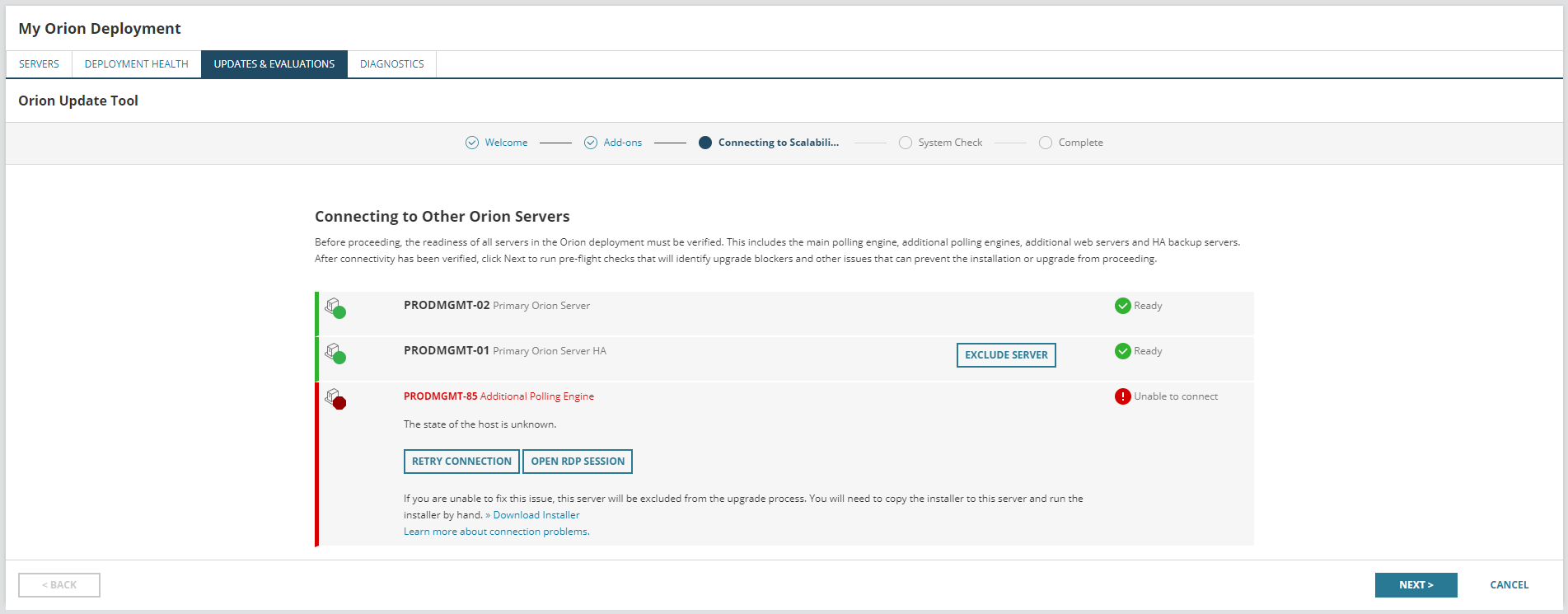

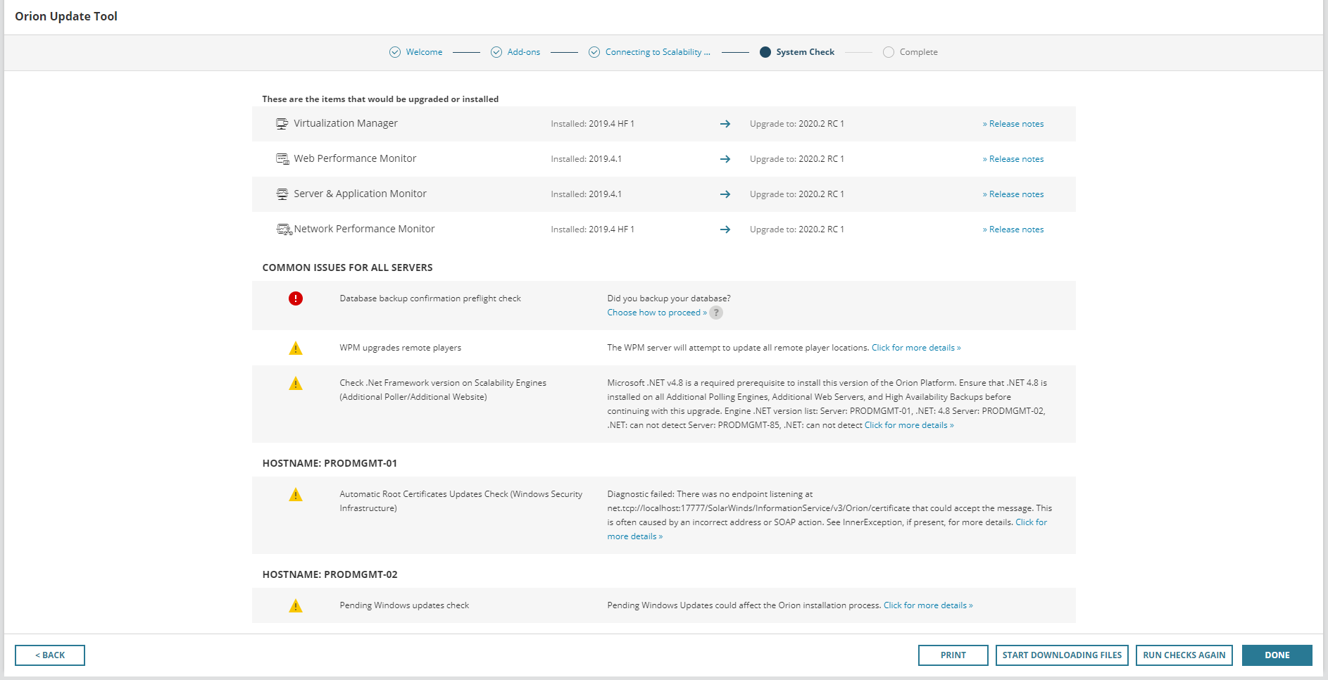

That problem should now be reconciled, so we begin with the Make a Plan option. Clicking on this button will take you through a workflow you may also recognize, indicating what modules and versions you are currently running and what they will be upgraded to.
This screen also provides ample opportunity to learn about other products you may not be familiar with, but for the purpose of this walk-through, we will scroll down and continue on. The next step will focus on establishing a connection from the main poller to any scalability engines distributed within the environment. This includes Additional Polling Engines, Web Servers, or HA servers. If the system is unable to connect to a scalability engine, you will receive a warning with actionable information similar to below.
You may choose to rectify that issue immediately or move forward, it is up to you. The following step will perform what you will hear us internally call the pre-flight checks. In essence, these are system checks of each server that provide valuable feedback on optimizations that may need to occur prior to being able to upgrade, or recommendations to be mindful of before proceeding. For example, it would be difficult to install an update on a polling engine if that machine is out of disk space. These are items that you just may not be aware of that could cause hiccups or even prevent you from making progress if you were trying to move forward with an actual update.
At the bottom of the screen, you will see four separate options. These are really centered around completing the task of planning your upgrade, in which case you can click done, run your system checks again, or even retrieve a printable version of the page. This may be handy for some of you with change control processes that require documentation. Another new and notable feature is also a perfect segue into our next topic, the option to proceed to download files.

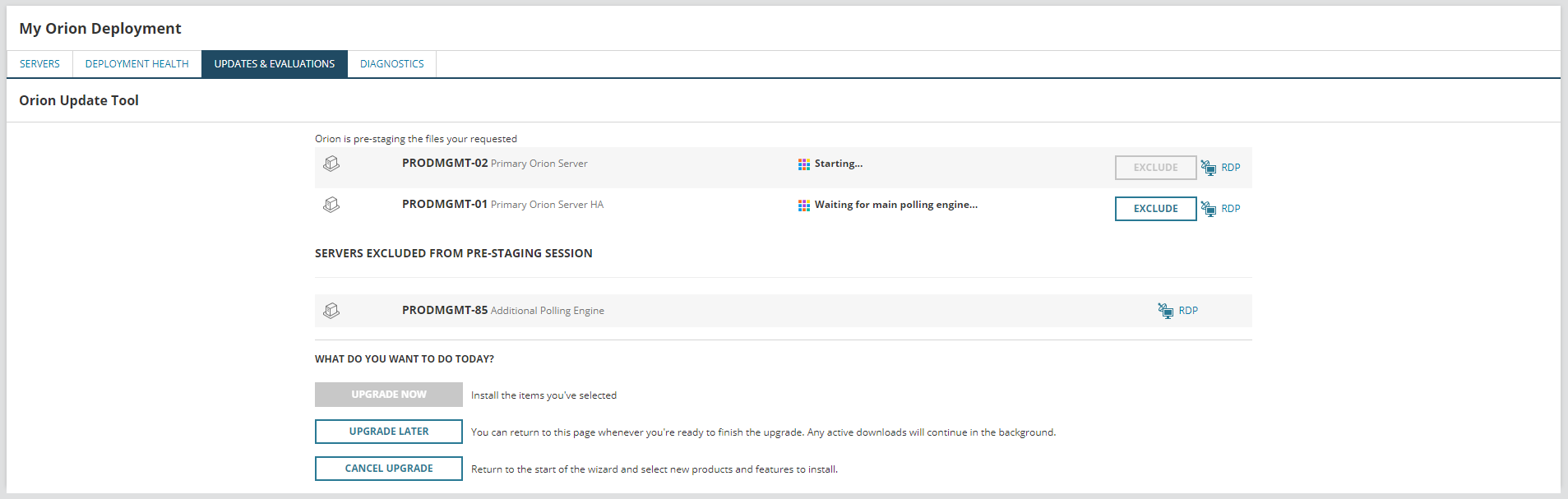

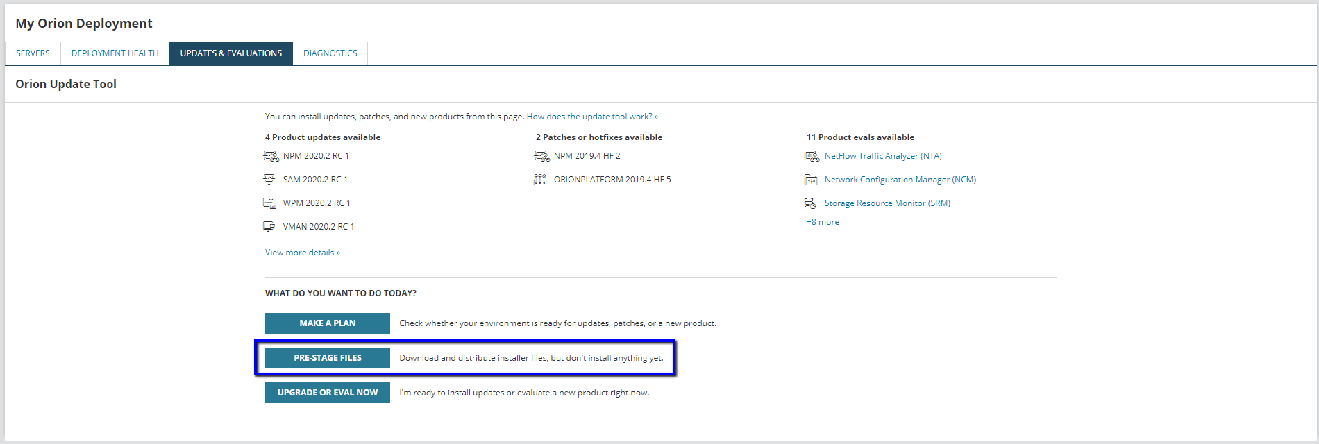

Pre-Stage Files
Selecting the Start Downloading Files button pictured above is, in reality, the same workflow as if we were to have chosen the Pre-Stage Files button on the first page pictured below.
The goal was to maintain a similar workflow throughout each of the three options, but ensure you had a clear and concise decision making tree, as well as stopping points throughout the process.

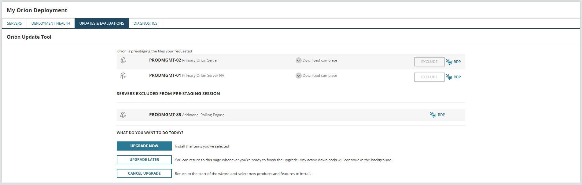

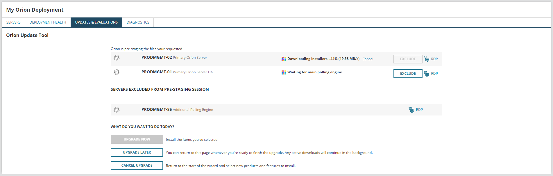

Proceeding through the workflow will guide you down the same path regardless of where you clicked the button, at which point you can now pre-stage your environment. What this provides is a mechanism to prep your environment ahead of time, where previously you either had to do this manually yourself, downloading and copying files onto each scalability engine, or include this overhead as part of your change window needed to complete the upgrade. This cuts all that extra work out of the equation with just a few clicks! Once you have begun this process, you are free to go back to what you were doing and come back to check on it later.
Pictured below, the staging begins with your primary poller and then transitions to upload bits to each of your scalability engines.
Feel free to go back to what you were doing or of course troubleshoot an issue if necessary. It has no effect on the upgrade. Upon return, you will be greeted with progress indicators and success indicators once completed. When it is time for the actual change window, come back to this page and simply click the Upgrade Now to proceed. Whether this is the next day or the next month it really doesn't matter, you are set and ready to upgrade!
As always, there is built in intelligence to centralized upgrades and if you return to this page, and a newer update is available, you will be notified and can make the choice to download the new bits prior to upgrading. Fear not, the system will also ensure that only new bits necessary for the latest update are downloaded, rather than having to download absolutely everything again.

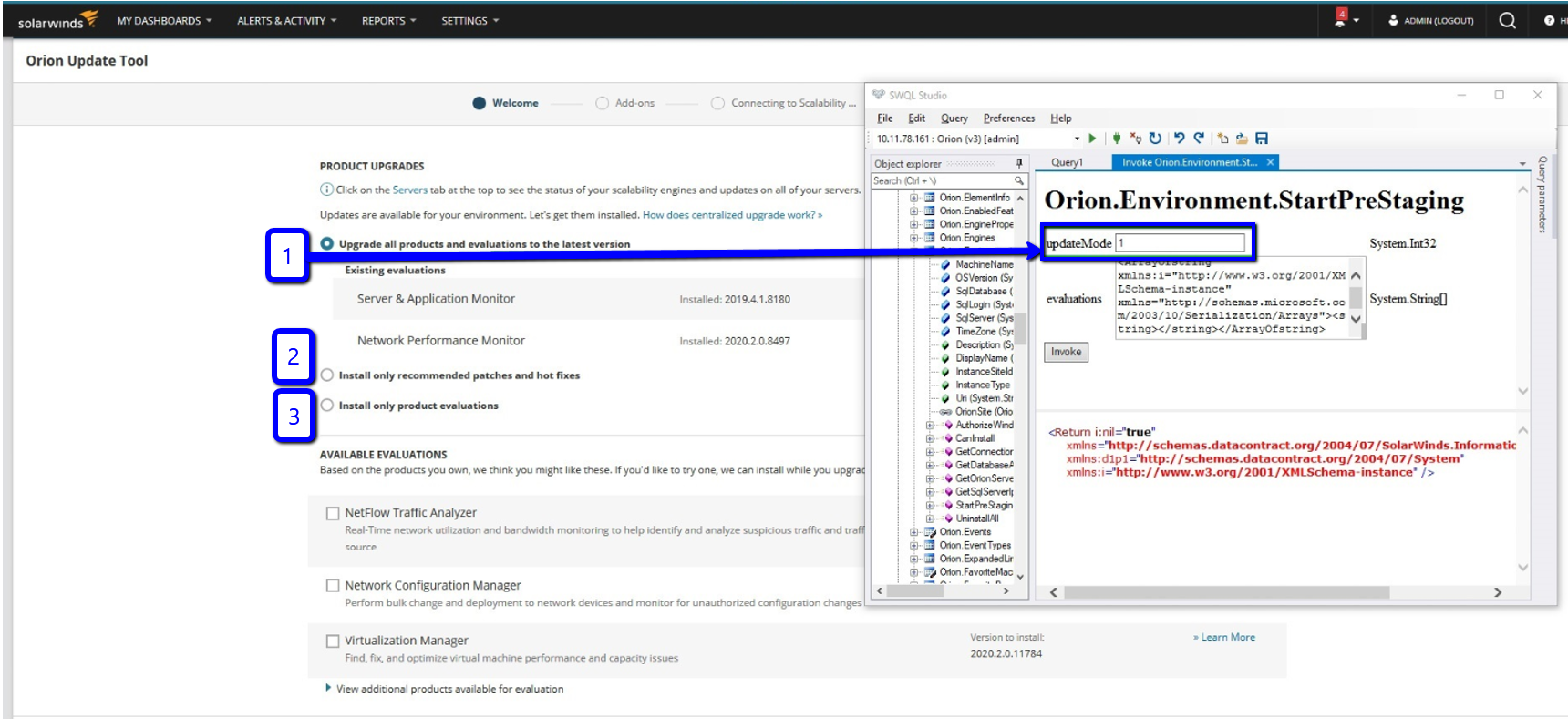

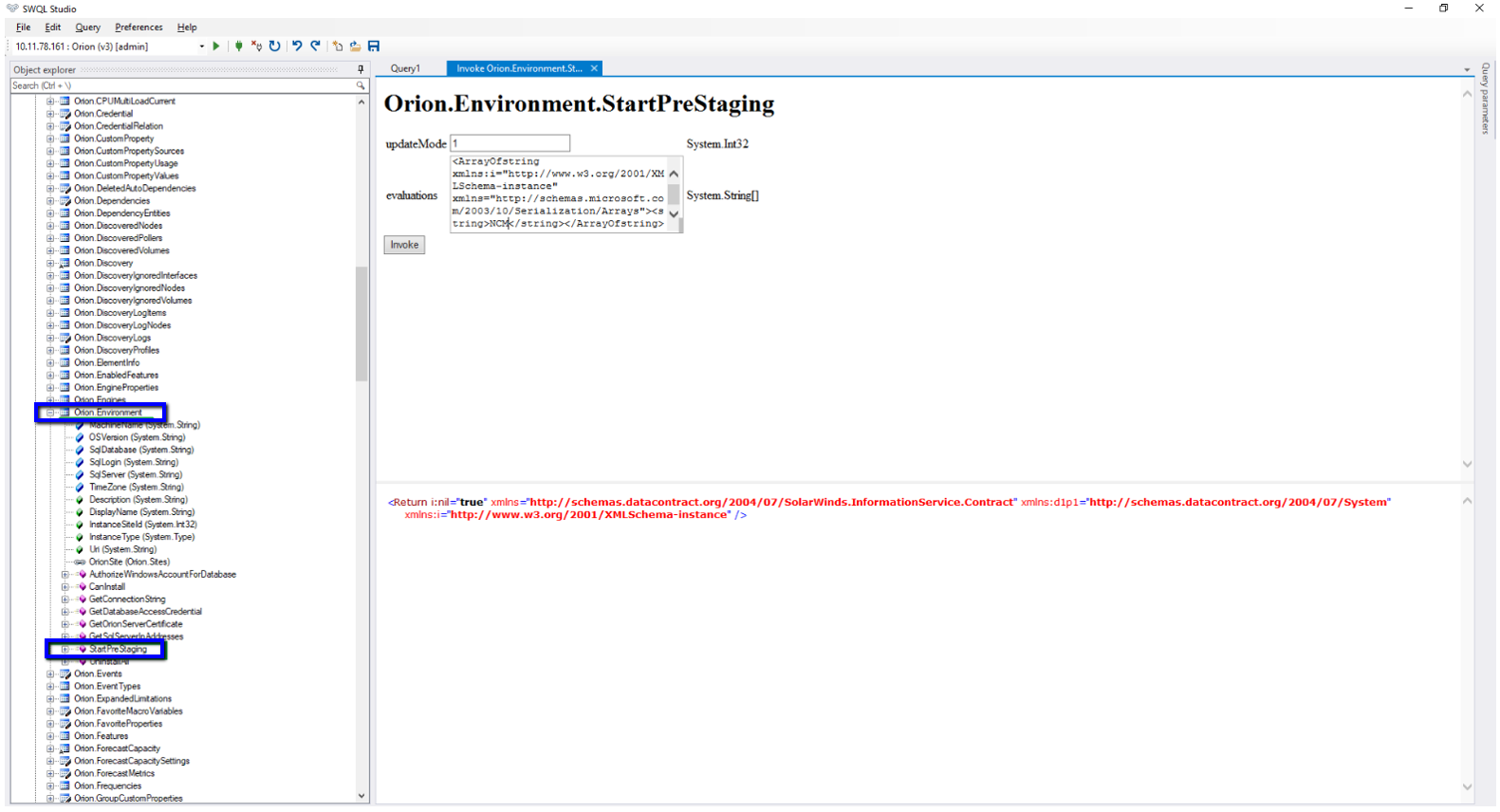

SDK and Configuration Wizard Improvements.
The team was also able to deliver new verbs into SWQL Studio to ensure that advanced users have the ability to automate pre-staging functionality through the SDK.
A new SWIS verb has been added to Orion.Environment entity and you have the ability to specify the "updatemode" as well.
  • Install & Upgrade = (1) - Arguments are optional
  • Hotfix & Patches Only = (2) - Arguments are optional
  • Install Only Evals = (3) - Arguments are mandatory for which eval products will be installed; NCM, SAM and so on.

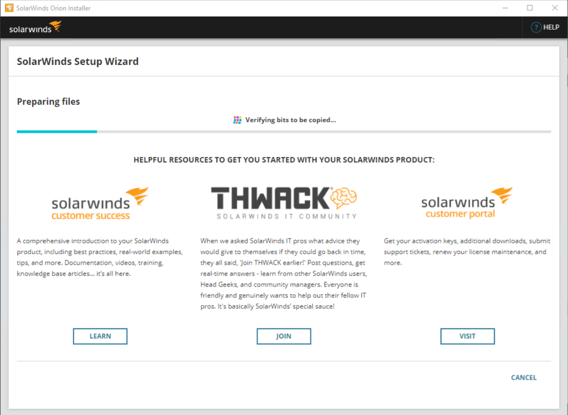

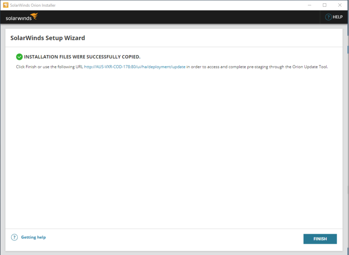

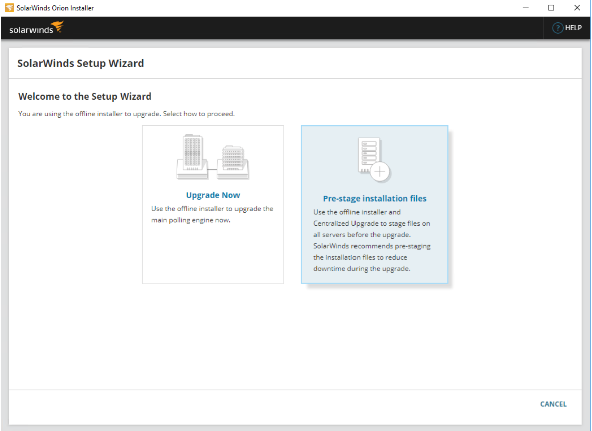

Want more good news!? As of 8/26/2020, offline environments can also take advantage of the Pre-Staging feature! Yes, this was one of the first questions asked once the original release was made available, and with the 2020.2.1 Service Release, we are happy to deliver Pre-Staging for offline environments. Just to reiterate what this means, when pre-staging, all services remain running and Orion continues to function normally throughout the process. This prevents you from spending significant time performing these actions yourself, as well as eliminating this task during your actual upgrade window. Only later, when you ultimately decide to upgrade, will there be any disruption in service. This disruption should also be drastically reduced thanks to the additional improvements made to the configuration wizard.
So, for those of you running offline environments you will immediately notice a different behavior from the typical offline installer as pictured below.
This allows you to choose your own adventure, and we certainly recommend using the Pre-Stage option. Once selected, the SolarWinds Administration Service will be updated and the installer will identify the necessary bits needed for your installation.

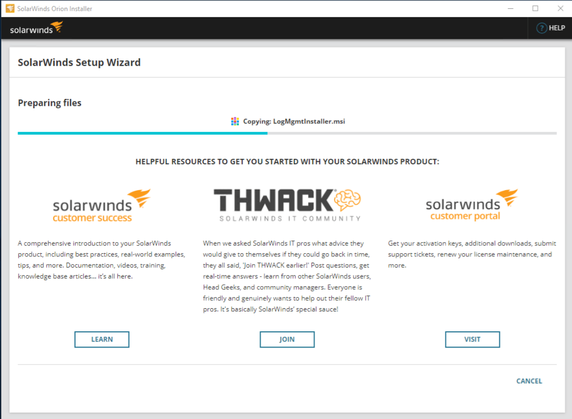

The appropriate files will then be copied from the .exe to the install directory of your server.
Once this is complete, you will receive a success message and directions that allow you to copy the URL or click FINISH to launch the Orion Update Tool.
From the Centralized Upgrades UI, you can now follow the same steps outlined above to either walk through the upgrade now, or pre-stage the necessary bits across all your scalability engines.
