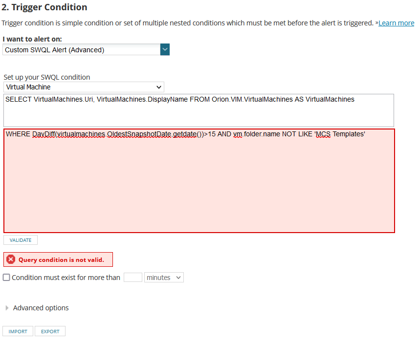

VMAN - Using SWQL to exclude VMs residing in a folder in vCenter from the results.
I've tried this with SWQL Studio with no success, but I'm wanting to build an alert to delete snapshots older than X days, but only apply to VMs that don't reside in a particular folder in vCenter so that we don't delete any snapshots on our Citrix MCS templates.
Googling around led me to the attribute, vm.folder.name, but it doesn't appear to be valid.

  • Thanks for the reply.  Although the WHERE query you posted validates successfully, adding the AND query to it makes it invalid.  I am unsure if vm.folder.name is correct or not with VMAN.  Any guidance there? Even if I did "WHERE vm.folder.name NOT LIKE 'MCS Templates'" as the query, it's invalid.

  • Lotta comments on this already, but seems like the main error is "vm" as in "vm.folder.name" is an alias that's not defined in the FROM statement, so it's invalid
    Usually engineers will do stuff like "Select x from orion.virtualmachines vm" at which point you can use vm.x to talk to stuff in the virtualmachines table.
    You've copypasted that in from somewhere it works i'd guess. Swap vm.for "virtualmachines" before anything else if you've not already
