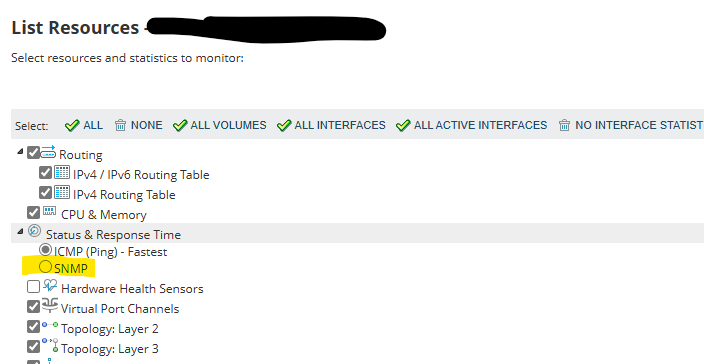

  • There is a case where one of the device still shows Green and polling method as SNMP under Managed nodes but actually the node lost its snmp connection to the tool so in this case polling method not showing correct result. so please need another way to find out.
  • The Polling Method is for statistical polling. Availability is by default ICMP ping and it is this which is reflected in the green status. So, although it is unable to collect SNMP statistics, SolarWinds is able to ping the Node, so it shows as Green (Up)
  • Select SNMP for status and it will show down when SNMP is not working.

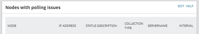

  • Try putting this SWQL into a Custom Query widget on your web console:
    SELECT
    NodeID,
    DisplayName,
    IPAddress,
    CASE
      WHEN ObjectSubType = 'SNMP' THEN 'SNMP'
      WHEN ObjectSubType = 'ICMP' THEN 'ICMP (Ping Only)'
      ELSE 'Unknown'
    END AS PollingMethod,
    LastSync AS LastPolled
    FROM
    Orion.Nodes
    ORDER BY
    PollingMethod, DisplayName
  • Check your node SNMP credentials and test the same again to see the result.
  • Hi Daran,
        I verified for that node and it has the ObjectSubType as SNMP and Last Sync as last polled but the device is not responding with SNMP now so this query doesnt satisfy the requirement.
    When I open the node in the solarwinds GUI and click List resources it says "us-dal-corp-lxcn02.dtcc.com is currently down, unreachable, or provided credentials are not valid" so I am pretty sure the node lost its snmp connection but ICMP is good. Hence I need to get the list which are snmp connection lost only.
    Thanks.
  • If SW is saying is it down then SW is doing it's job and you should be investigating why it is saying it is down -  you could try the following to get a bit more info...
    SELECT
        n.NodeID,
        n.DisplayName,
        n.IPAddress,
        n.Status AS NodeStatus,
        n.StatusDescription,
        n.ObjectSubType,
        n.LastSync AS LastPolled,
        n.DetailsUrl
    FROM
        Orion.Nodes n
    WHERE
        n.ObjectSubType = 'SNMP'
        AND n.Status IN (9, 14)
    ORDER BY
        n.DisplayName
    but other than that you should be troubleshooting the issue on your network rather than here...
