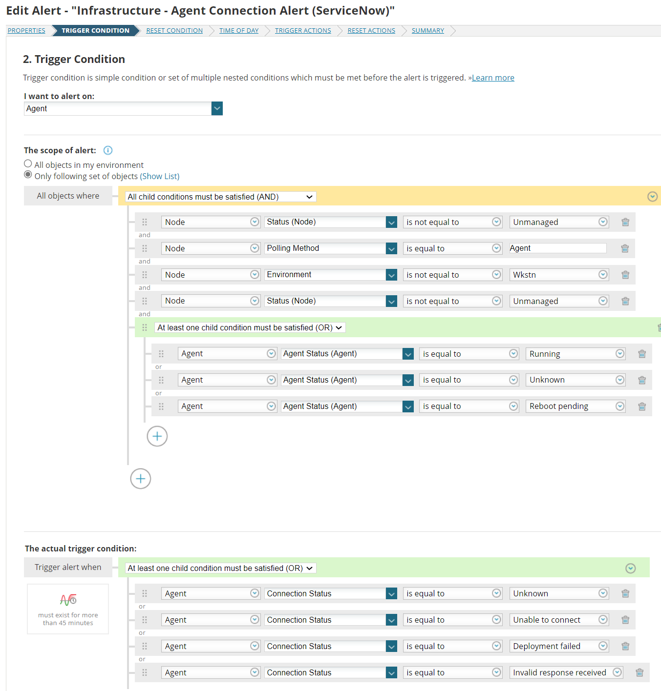

  • Here is the trigger condition for our alert if the agent is not responsive.

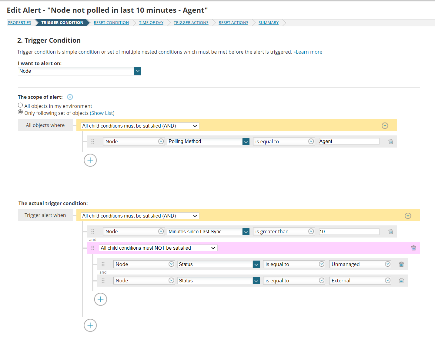

    The default alert may be enough for what you are looking for. Copy "Node not polled in last 10 minutes" and add in Agent.
