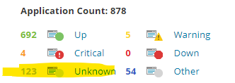

I have attempted this twice now doing both the Main Polling Engine and then the APE. The migration seems to go fine and the website is up but then random application monitors go to an unknown state then some some back up then go unknown again. We poll them all with WMI using fixed port  24158, I have had to revert back both times due to all the false unknown alerts we got. We have around 800 app monitors and over 400 would go unknown.
First time I tried working with support and all they could come up with was to upgrade Orion to 2024.1 which I did. Then I tried again and the same thing happened except this time it was only around 130 app monitors. It doesn't matter which polling engine the node and the monitor is on but its only the two I migrated. Nodes with the agent installed work fine.

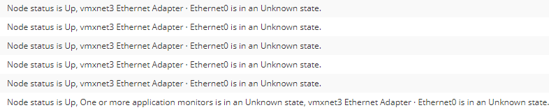

Also ALL the nodes except ones with agents on those two polling engines show Ethernet Adapter is in an unknown state.
