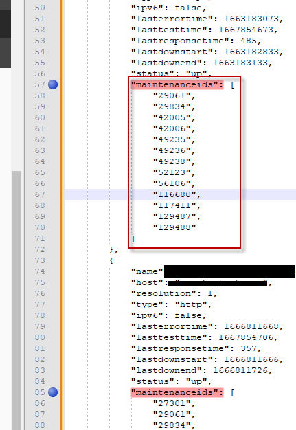

  • Thanks for the input! I was able to extract the checks with postman and even able to post a new check. Now my struggle is formatting the check output from the environment I want migrate so it will POST and create the checks in the new account. I have around 200 checks so filtering the output is tricky.

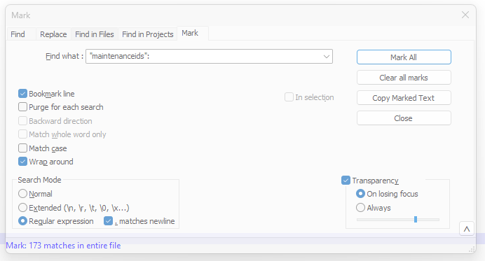

    I could use some regex help at this point. See the screenshot sbelow. I'm using Notepad++ to Find and mark all rows, then deleting them.
    I need some help selecting\marking all rows highlighted in the red box. The "maintenanceids" repeats itself in each check so the select needs to stop at the ].
    Any ideas on how to write this regex find?
