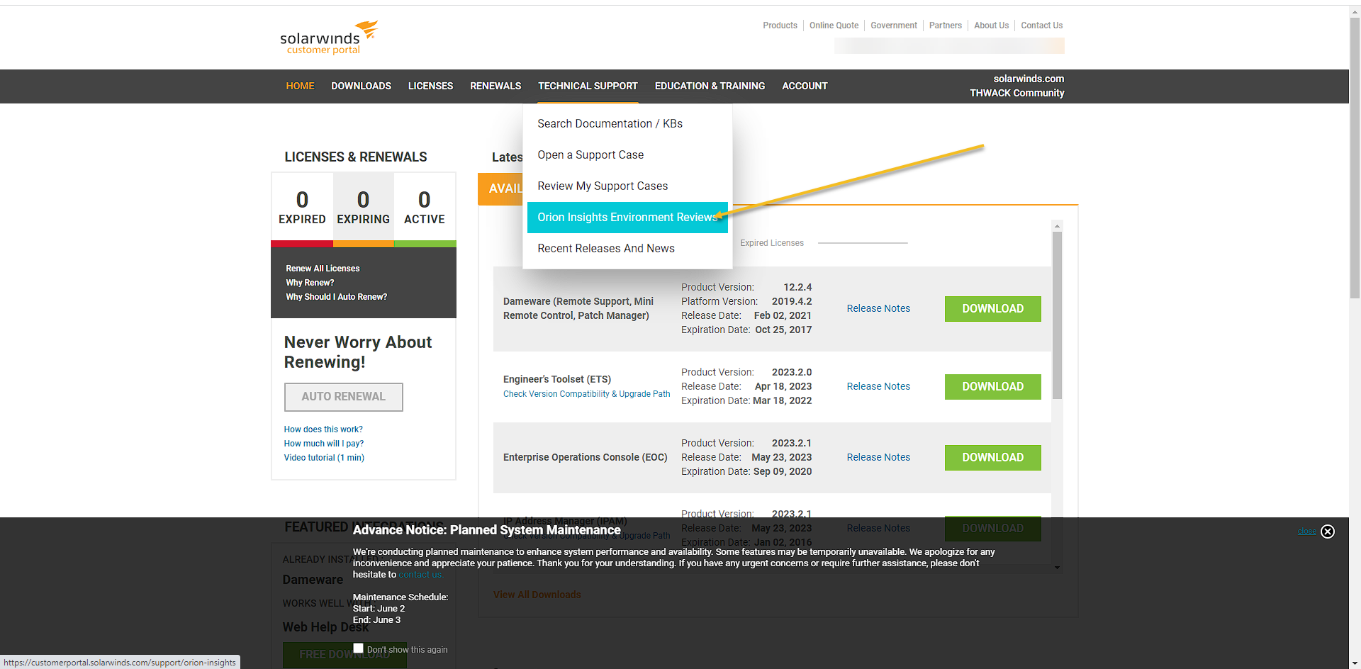

  • Have you tried gathering the logs and then submitting Orion Insights?  Just to check if there would be potentially environmental issues that you can eliminate to improve the Polling?
  • No, I have not because we have manually checked everything. We have multiple tickets with support many escalated all the way to the top and support doesn't believe it to be environmental. Which is something we share or it would of shown itself more widely. This is in the mechanism of the software itself. Where there is no log that explains why it happens but it does.
