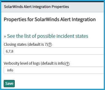

  • Are you using the ServiceNow integration to create incidents from your alerts?  If so, are you auto-resolving by setting the State Management: Reset State = Resolved?  You may need to set the state to Closed.  I believe that'll generate a new incident the next time the alert triggers.
    https://documentation.solarwinds.com/en/success_center/orionplatform/content/core-servicenow-how-it-works.htm
    If you need to set the status to Resolved, you will probably want to modify the ServiceNow configuration properties.  Add "6" to the Closing states.
    This is the route we took where I work.  If the technical support person Resolves the incident, we want to generate a new incident the next time the alert is triggered.
  • Thanks lorenrichardson. The way you solved it looks interesting; I didn't know that was an option.
    The way I ended up solving this is by setting the reset state to "closed". After doing that I ran into another problem with not being able to add notes in ServiceNow for a closed ticket. I talked to our ServiceNow admin and she enabled "Work notes" for closed incidents.
