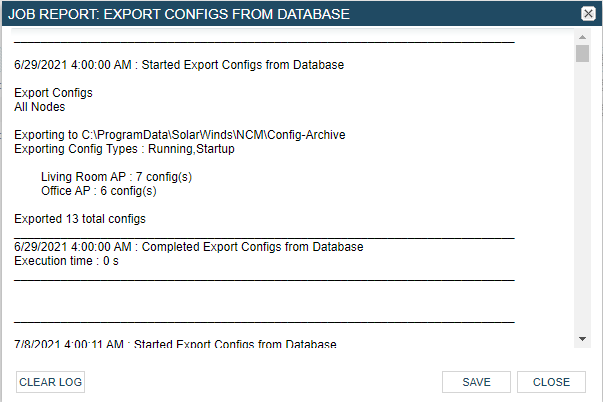

  • Are you seeing it from the Jobs list (/Orion/NCM/Resources/Jobs/JobsList.aspx) page?
    When I click on the history icon   I'm getting a modal box with the logs.
    Then if I click save, the file seems to download fine.
    I'm running Orion Platform 2020.2.6 HF1 with NCM 2020.2.6.
