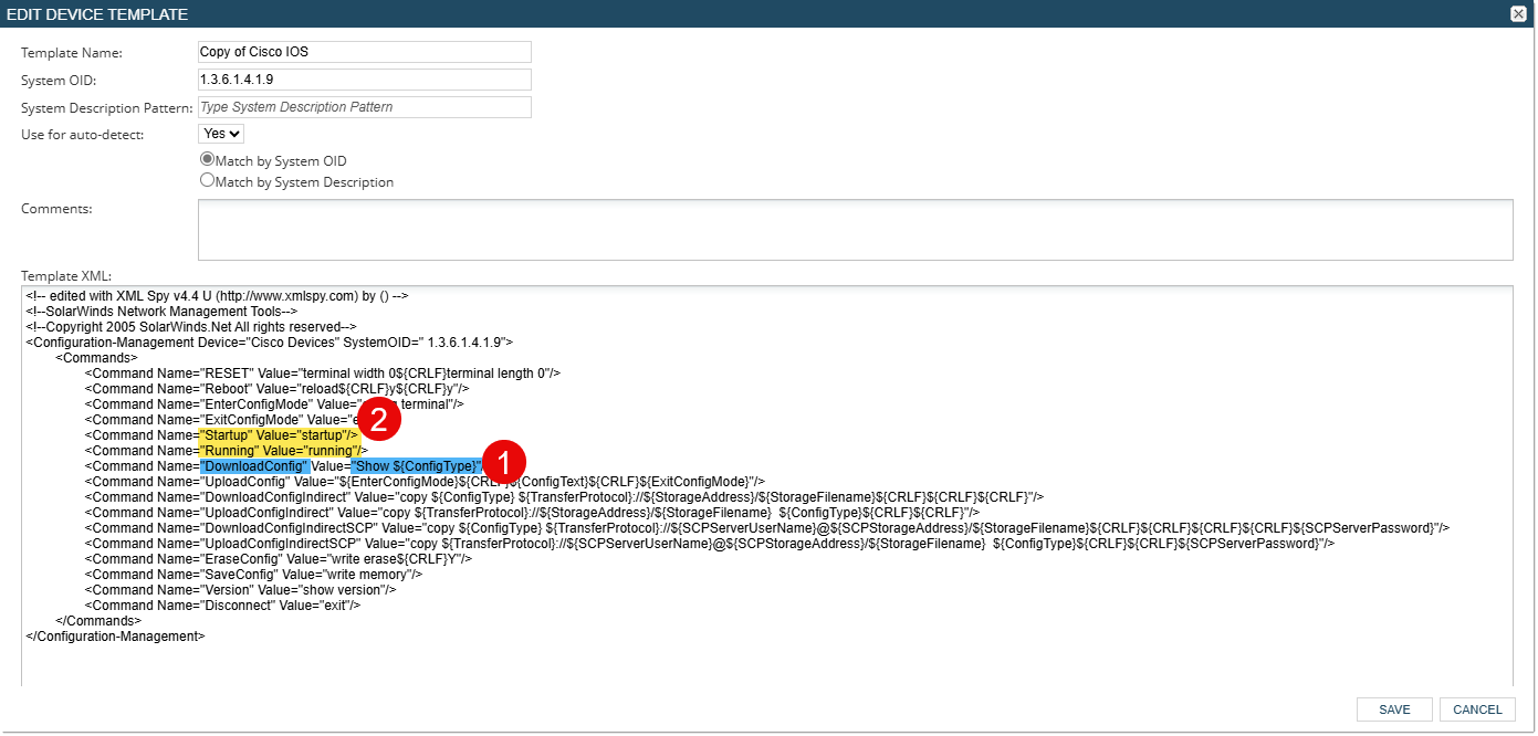

    The main command is #1 in the below screenshot.
    <Command Name="DownloadConfig" Value="Show ${ConfigType}"/>
    This basically means that it is going to execute 'Show' plus whatever text is translated from the ${ConfigType} variable.

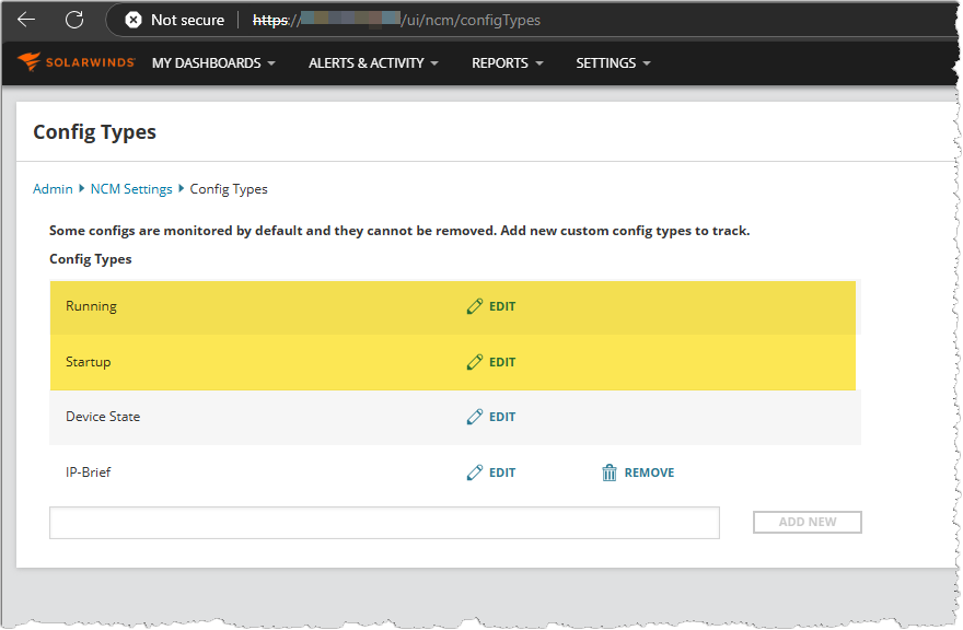

    #2 has config types defined as 'startup' and 'running'. So if I selected to back up a running config it would use 'Show ' + 'running'.
    You can see the defined config types under NCM Settings > Config Types

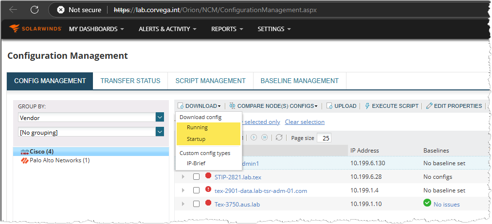

    When you're on the Config Management page, you'll see reference to your config types under the 'Download' button.
    So on the front end, you click Download > Running.

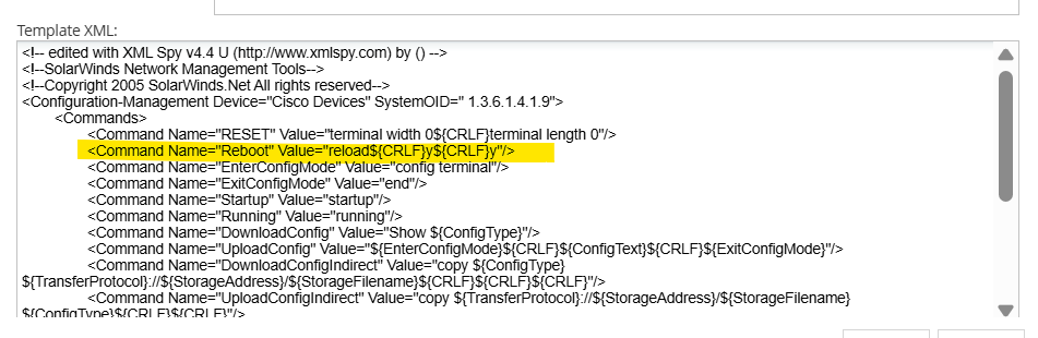

    To take another example of 'Reboot'
    <Command Name="Reboot" Value="reload${CRLF}y${CRLF}y"/>
    The device template has a command name of 'Reboot' that executes a 'Reload + <enter> + y <enter> + y'

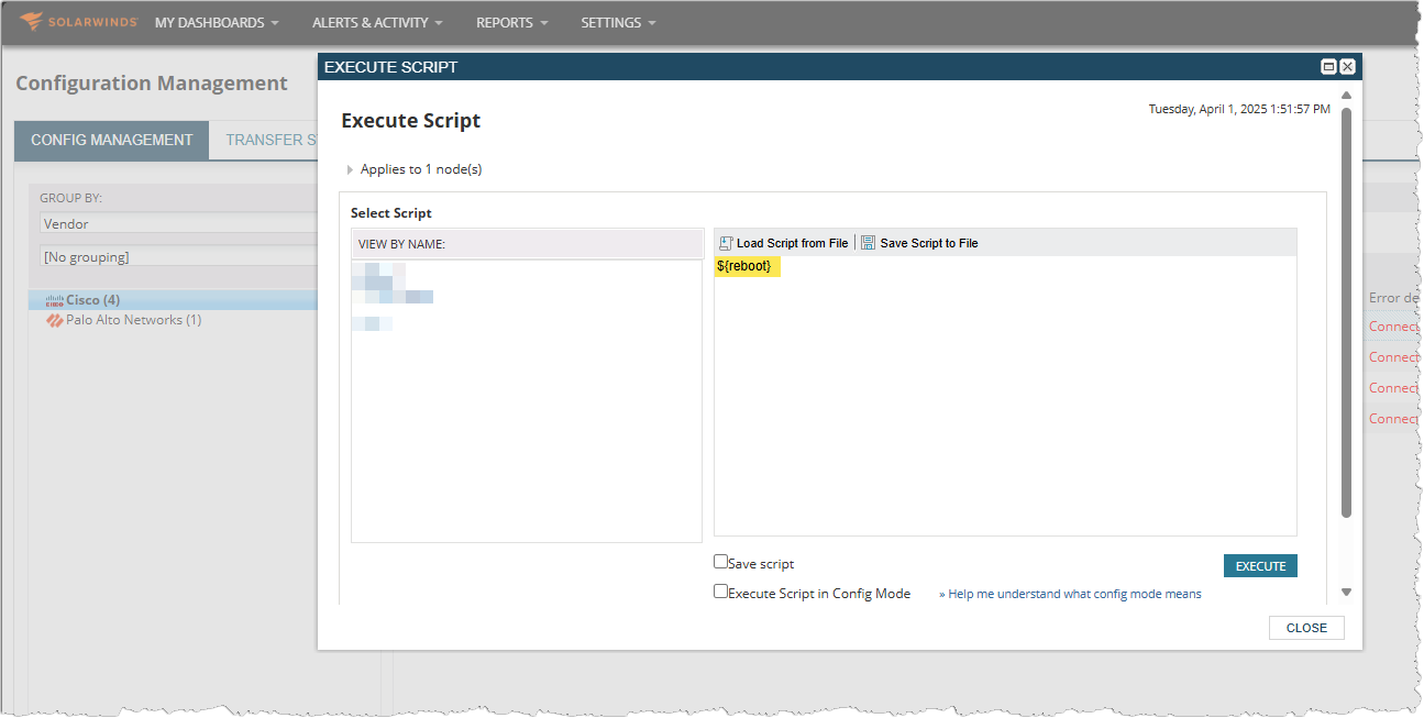

    These device template commands can be referenced throughout NCM.
    If I was on the Config Manage page and clicked on the 'Execute Script' button, i could simply type ${reboot} and click execute.
    It would then go back to the Device Template to see if there is a reboot command and execute it if there is.

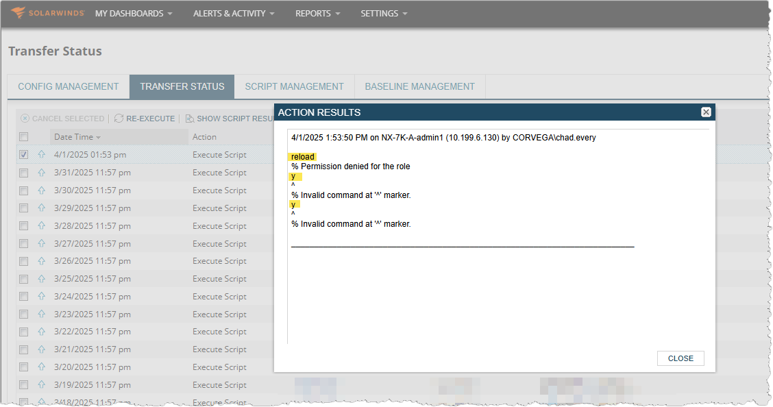

    My lab has permissions locked down, so the screenshot below shows the results of me executing that command (which was denied) of 'Reload' + <enter> + y <enter> + y'
    This means that you can have device templates have syntax specific commands while all using the same NCM variables. This can help with management across different vendor CLI.
