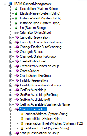

  • https://solarwinds.github.io/OrionSDK/swagger-ui/#/ + SWQL studio from the SDK from the github is what you want
    Something like that looks like it from SWQL
    Not using ansible or ipam much at the mo
  • To expand on your questions a bit
    There's a rest API, if you use it you'll end up using SWQL sooner or later for querying something. There are API calls with no SWQL though.
    1/2 on sufficiency, on a technical level you need time and such as in my SS, or on  non-technical level depends on your org i suppose.
    I think release is Cancel or Remove.
  • THANK YOU
    It's extremely useful and what I was looking for.
    I guess I need to play around those settings as soon as I get access to the systems.
    First of all I need to find how the IPs are "reserved". Are they reserved as DHCP records, or it's just a "available" "not available" status?
    Then, I need the correct option (unfortunately I cannot find what I have to type there, but I believe that's for another day).
    But many thanks, it's a very good starting point
  • Someone IPAM-ey will have to jump to help from there I think, I'm more familiar with the api stuff
