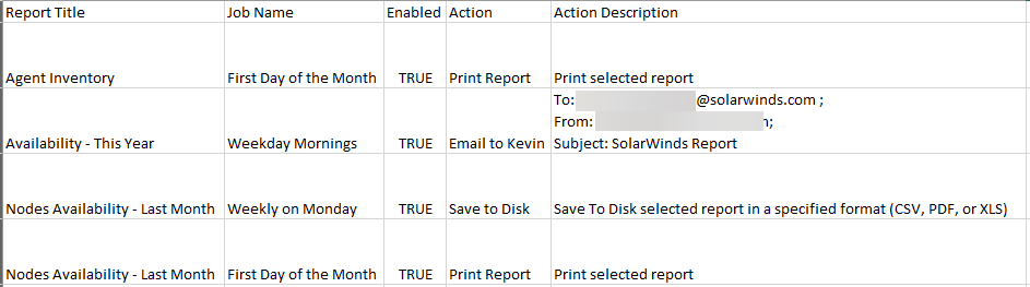

  • Here's a PowerShell version that should give you enough details to go off of.

    The output looks like this:
