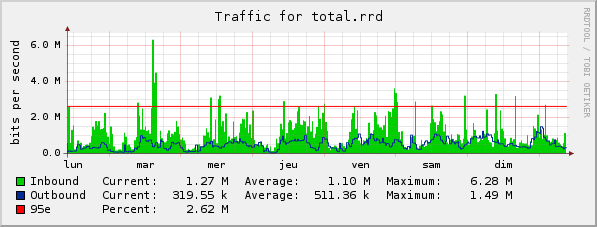

  • Our preferred calculation are the following:
    • Take the max(in, out) for each interval and use that as the source. This method is more complex to implement as it requires processing of each sample but results are closer to estimating total volume of data sent and received.
    Example what it should look like as graph:
    In a form of table with the following fields:
    timestamp,Devicename,Interfacename,MaxIn,MaxOut,95e
    The reports (table,graph) should be over on month to sent it to our customer
    Thank you
