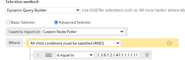

For one client, we are using a custom node poller a la:
The SWQL, which is meaningless to me or in SWQL Studio, for this is:
SELECT [data].[DisplayName] AS [DisplayName],[data].[Node].[DisplayName] AS [DisplayName1],[data].[InstanceSiteId] AS [InstanceSiteId]
FROM orion.npm.custompollerassignmentonnode AS data
WHERE
((([data].[CustomPoller].[OID]) = ('1.3.6.1.2.1.47.1.1.1.1.11')) AND (([data].[Node].[CustomProperties].[Client]) = ('XYZ')))
WITH NOLOCK

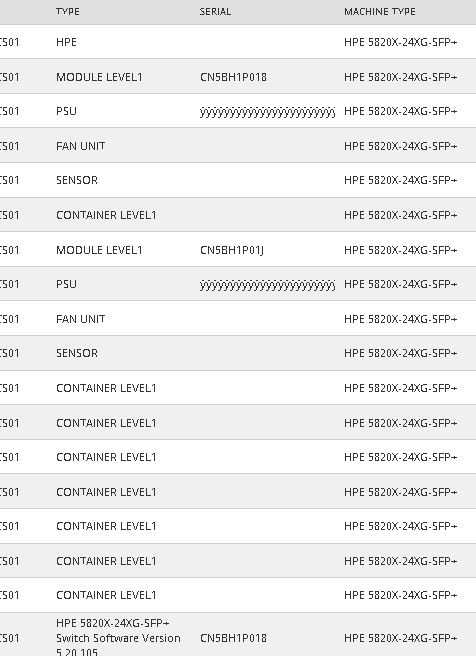

And when we add relevant columns to the custom table, the end report looks like a bit like this:
What I think we need to do is extract just the 'Module LevelX' part -- or -- the section that has:     but I suspect, if feasible, the easier one would be Module lLevel1.

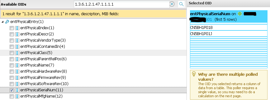

When I browse the OID (1.3.6.1.2.1.47.1.1.1.1) via the MIB Browser
Other devices might have multiple blue lines between the serials, but what remains consistent in the report output is the Module line and/or the HPE Model lines.
Question: so is there a way to create the report to just show the relevant lines?
