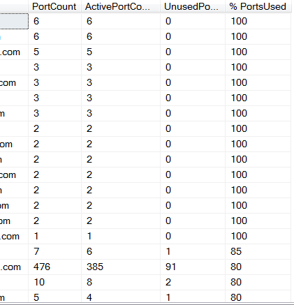

  • I have no idea where I got this from - I didn't write it.  I'm sure someone on thwack wrote it, but here's the SQL that I think you want.
    SELECT
        [N].[Caption] AS Caption
        , ISNULL([PortsTotal].[PortCount], 0) AS PortCount
        , ISNULL([PortsActive].[PortCount], 0) AS ActivePortCount
        , (ISNULL([PortsTotal].[PortCount], 0) - ISNULL([PortsActive].[PortCount],0)) AS UnusedPorts
        , CASE
            WHEN ((ISNULL([PortsTotal].[PortCount], 0) = 0) OR (ISNULL([PortsActive].[PortCount], 0) = 0)) THEN 0
            ELSE ((ISNULL([PortsActive].[PortCount], 0) * 100) / ISNULL([PortsTotal].[PortCount], 0))
        END AS [% PortsUsed]
    FROM dbo.Nodes AS N
    INNER JOIN dbo.UDT_NodeCapability AS NC ON (([N].[NodeID] = [NC].[NodeID]) AND ([NC].[Capability] = 2))
    RIGHT JOIN (
        SELECT [P].[NodeID], COUNT([P].[PortID]) AS PortCount
        FROM dbo.UDT_Port AS P
        WHERE ([P].[Flag] = 0) AND ([P].[IsMonitored] = 1)
        GROUP BY [P].[NodeID]
    ) AS PortsTotal ON ([PortsTotal].[NodeID] = [NC].[NodeID])
    RIGHT JOIN (
        GROUP BY [P].[NodeID], [P].[OperationalStatus]
        HAVING ([P].[OperationalStatus] = 1)
    ) AS PortsActive ON ([PortsActive].[NodeID] = [NC].[NodeID])
    WHERE (ISNULL([PortsTotal].[PortCount], 0) > 0)
    ORDER BY [% PortsUsed] DESC, [ActivePortCount] DESC, [UnusedPorts] ASC
    the report looks like this (caption is the first column - cropped out)

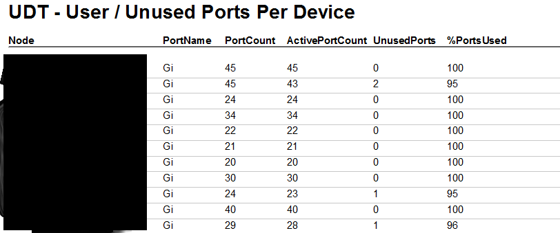

  • Hi,
    Replace all occurrences of "right join" with "left join", the report will work then.
    Or you can try this modified query (for UDT 2.5+), it will give what you need though in a slightly different way.
    Let me know if you'll have any troubles with that.

  • FormerMember
    0 FormerMember in reply to Bedrich.Michalek
    Nice work Bedrich!   My original query works great with changing the joins.  However, I love your revised query.  It's actually what I preferred the report to be but couldn't figure out how to write the query.  My query ends up taking up way too much report landscape real estate.  You da'man!  I owe you a beer. emoticons_happy.png   Thank you!
