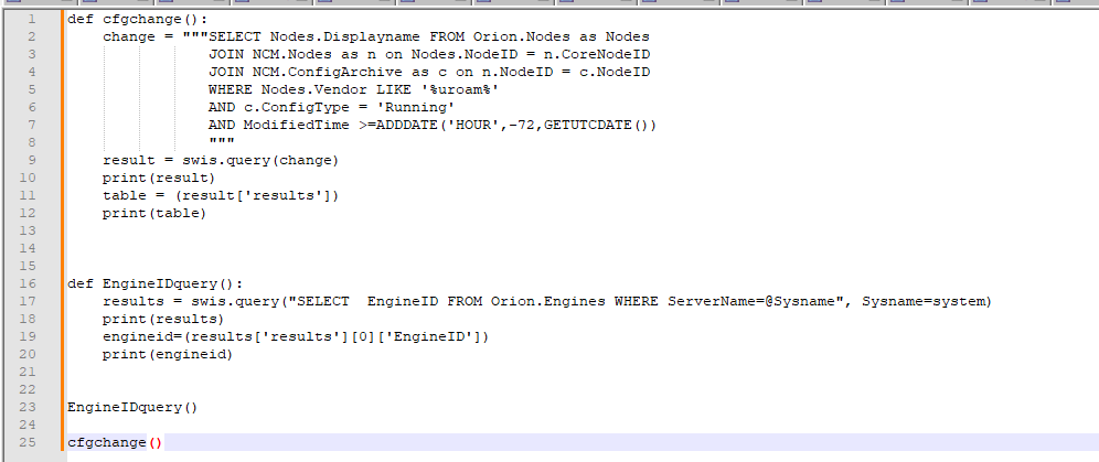

Query that works:
def EngineIDquery():
results = swis.query("SELECT EngineID FROM Orion.Engines WHERE ServerName=@Sysname", Sysname=system)
print(results)
engineid=(results['results'][0]['EngineID'])
print(engineid)

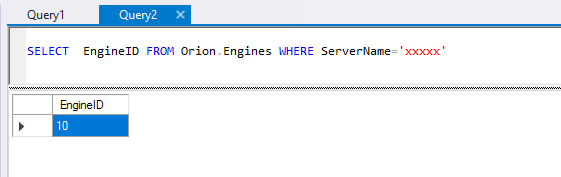

and this is the print output
{'results': [{'EngineID': 10}]}
10
Output from swql studio
Query that returns blank
def cfgchange():
change = """SELECT Nodes.Displayname FROM Orion.Nodes as Nodes
JOIN NCM.Nodes as n on Nodes.NodeID = n.CoreNodeID
JOIN NCM.ConfigArchive as c on n.NodeID = c.NodeID
WHERE Nodes.Vendor LIKE '%uroam%'
AND c.ConfigType = 'Running'
AND ModifiedTime >=DATETRUNC('HOUR',ADDHOUR(-72,GETUTCDATE()))
result = swis.query(change)
print(result)
table = (result['results'])
print(table)
print outputs are

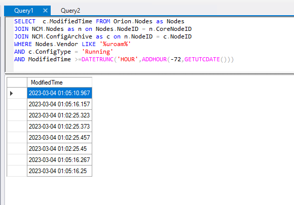

{'results': []}
Output from swql studio ( i subsituted sensitive data for modified time column)

    I get the same outcome, the query returns results when running it in swql studio but when running from python script results are blank

    So both queries run but i only see results from engineid, i dont see any results to extract from cfgchange
    ========= RESTART: C:\Users\xxxx\Desktop\Python tests\Test-query.py =========
    10
    {'results': []}
    If i hash out engineid() so only cfgchange runs its the same thing no results, yet running that exact query in swql studio returns the results i am after

    Used the Cirrus entries and get the same result, running the query in SWQL returns the results I am after but running the query from python script on the Poller returns blank.
    I am trying to get the devices that config has changed on so i can run the rest of the script to export the config backup file to a server, at the moment i am exporting it every night but not really efficient this way.
    I am working on another way to pull this info from the device directly but the swql query would be the easier option.
    Thanks
  • Python needs to point to the Primary Polling Engine because of the way that the authentication takes place.  If you point it to your Main Polling Engine, does it return results?
