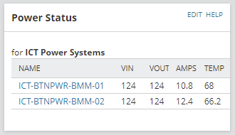

  • Here is what it should and does look like with out limitations.
    The limitation setup is just a restriction to a specific group of nodes.
